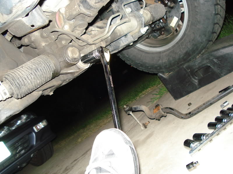

The only time I used a breaker bar (and car ramps) was to *remove* the driver's side bolt like so...

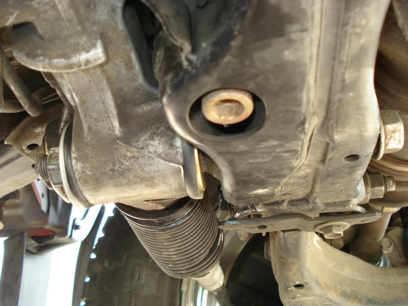

i've change my steering rack bushing the other day cause them are worn out i'm new here on this site and i owened a 024runner i took an image of the passenger side bracket for info it looks like it's crooked???
[IMG][/IMG]

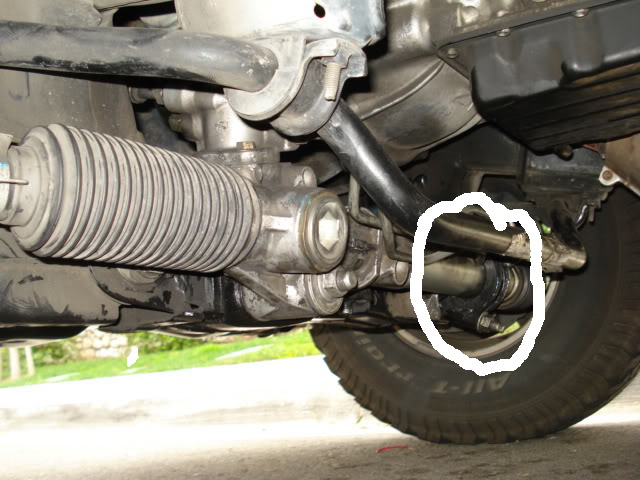

Let me know guys if its crooked cause i noticed that the lower bolt is facing down as shown here on the encircled image
thanks
B
Old Mar 14, 2009 | 05:42 PM
Nuthuts96's Avatar
Joined: Feb 2007
Posts: 419
From: Shelburne, VT previous: Everett, WA; Bellingham, WA
that doesn't look too good. looks like that stud is bent- just bushings won't help that. you're going to want to take that bushing/housing off to see the damage that's done.

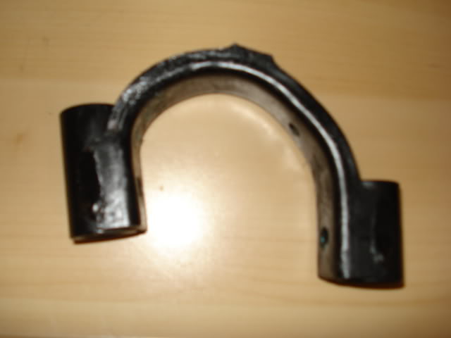

New bracket
this is the old one i had to replace i dont know what cause this to bend like it is......
