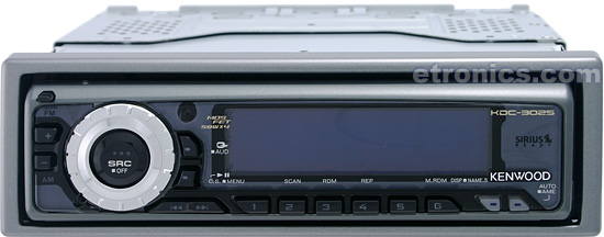

i just started fixing up my car system. found this site. Check out their car audio section. they can save you a fortune. I bought my head unit and speakers after using this site. they price shop for you. I will shop here from now on.
http://www.pricegrabber.com/home_catpage.php/catzero=31
i got this head unit for only $120 shipped.
