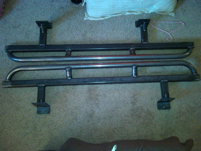

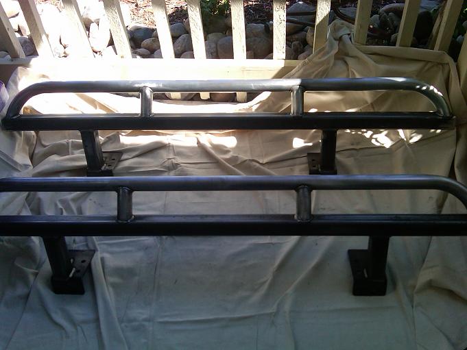

Ok, I've had a lot going on since the campout, so I am just now getting the sliders painted. Halfway done. and here are some pics. Let me just say that it makes it 100x harder to do little projects like this when the only place I have to work on them is my balcony! More to come soon. The first is obviously pre paint, and the second is after 3 coats. Once that dries for a few hours, I will flip them over to paint and rubberize the top.

The length they are is perfect. They fit perfectly on my 99 with the sport package fender trim. Drilling those holes is a PITA - make sure you have sharp bits and a nice step bit. I thought about bolting mine on then decided to have them welded in place. I'm sure they'd be plenty strong bolted on, it was just easier to have them welded.

well, I got that message a day too late. lol. A buddy and I went to install them yesterday and were quite puzzled as to how in the hell to drill the holes on the upper frame?!?!?!? So after an hour or so of trying to figure it out. we just decided to say screw it and I will weld them on later.

You should be able to do it with a right angle drill. Welding is probably the better option, especially if you don't foresee the need to take them off.

Make sure you weld on plates to the frame where you are going to weld them. they frame needs the bracing to hold up against jarring. Coming down hard on them can rip the frame where they are welded without them.
