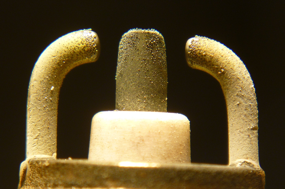

Well I tried this before changing the spark plugs to new ones, and didn't notice any of the build up removed from the old spark plugs. They looked the same before and after the treatment. Looking into the cylinder with a flashlight looked the same also.
