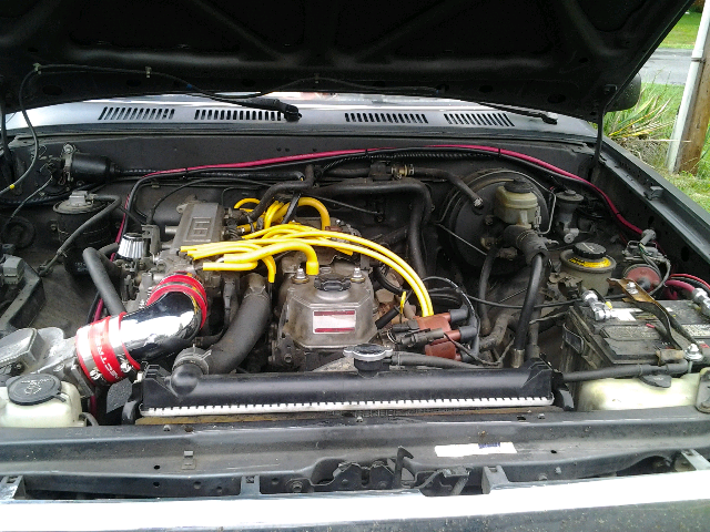

I did this to my truck last weekend. I used distilled water and regular blue washer fluid. I didn't take pictures while I was doing it but I used the one of the vacuum lines you see here going across the valve cover and I know it's a 6mm line.
I hooked up my timing light and set it in a little spot next to my sure filter so I could read it while I was doing this. I mixed the water and washer fluid 50/50, held the throttle close to 3000 by hand and stuck the vacuum line in the bottle letting it suck up about 1/3 of the bottle before I pulled it out. I reattached the vacuum line while still holding the throttle open and didn't let off until the spitting and sputtering stopped. Then I went for a drive and watched the tailpipe in my mirror until no more steam came out. I did this 3 times with no issues and went thru the whole gallon of mix. Then I moved on to the Seafoam. Using the same vacuum line I let it suck in half a bottle and let the throttle go so the engine would stall itself. After letting it sit for about 2 hours I fired it up and pissed off the neighbors. After the smoke cleared (about 10 minutes) I let the engine get good and warm and then went for another drive. When I got back home I added half a can of Seafoam to the oil and did the treatment one more time. This time I let it sit overnight. The smoke the next morning compared to the night before was like comparing a forest fire to a campfire. I'd be willing to bet a cockroach couldn't have survived that stuff. That afternoon I changed my water...i mean oil.
I have to say the engine runs smoother now. I'm sure I'll have to continue this on a regular basis as the truck has 23 years worth of crap in it, but I can tell the difference.
I also took pictures of my spark plugs before and after and did before and after compression tests too just to see if it made a difference. Unfortunately I can't load the pictures from my phone right now. I'll have to adjust the size on a computer first.
Here are the results of the compression tests:

The vacuum line I used is lined up more with cylinders 1 & 2 which explains why the compression changed for them but not for 3 & 4. I would recommend using a more central vacuum line or maybe doing half in that vacuum line and half in a line father back on the intake to make it even. Regardless I'm happy with the results and I'm glad for the chance to learn something new.
I hope this helps someone or at least gives them something to think about.

It does appear that you are getting more to #1/2 so changing the injection location should improve that. Every intake manifold is different and flows different. There is no perfect solution for them all. Just got to play with it and see what works best for your engine.
The most important thing is to not use a line that is obviously biased or only feeds 1 cylinder.
Next time I would change 2 things besides the injection location. I would put the seafoam into the oil at the start of this process or even a week or 2 before you plan to do it. I generally put ~100 miles on the seafoam before running the rest of the treatment and changing the oil.
I would also put some MMO into the oil at least a week or 2 ahead of time. The MMO is recommended that you run it in the oil at every oil change on the bottle anyways so I doubt that it will hurt anything but it is up to you.
I am running it in my oil on a constant basis right now at least until I feel that it has cleaned everything out of the engine. Just doing more frequent oil changes to compensate for the junk it cleans out.
It was after I started putting the MMO and seafoam in the oil that I noticed the big gains in compression. Before that it was just minor gains of a few psi here and there although other things were improved such as vacuum, idle and power.
Still took time for it to work though, it has taken about a year to go from my mixed results of 135psi-170psi to my now 205psi across the board. Running MMO in the oil constantly in that time and running the seafoam treatment with every oil change (which admittedly has only been a few, I don't put many miles on it).
In my case though I am pretty much positive that the cause of my low compression was stuck rings and the MMO/seafoam in the oil will work on those better then through the intake.
The intake side will work better on carbon build up, bad valve seal, hot spots the top compression ring among other stuff. So it will really depend on where your engine is dirtiest and needs the most help. I do both to ensure that everything gets clean.
