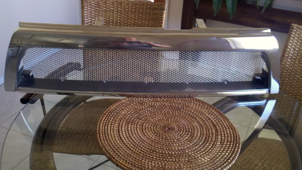

For the Mesh, I was able to get a pre-cut piece at my local Home Depot for $2.69. Here are some pics of the unpainted mesh after I was done cutting it:

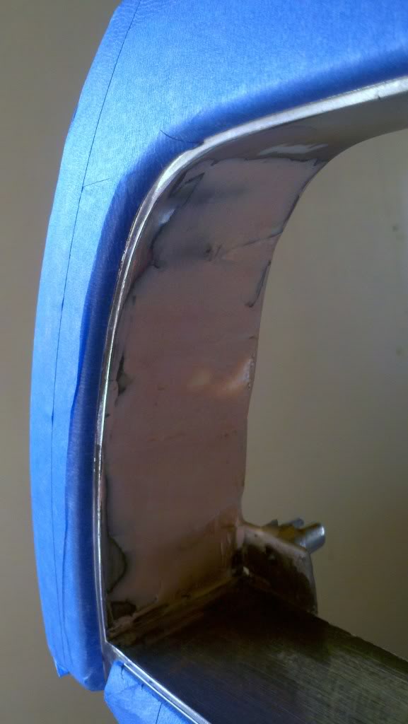

Next, it was time to cover the holes that were left on the grill after cutting the center piece. I used fiber glass & Bondo to cover the holes.

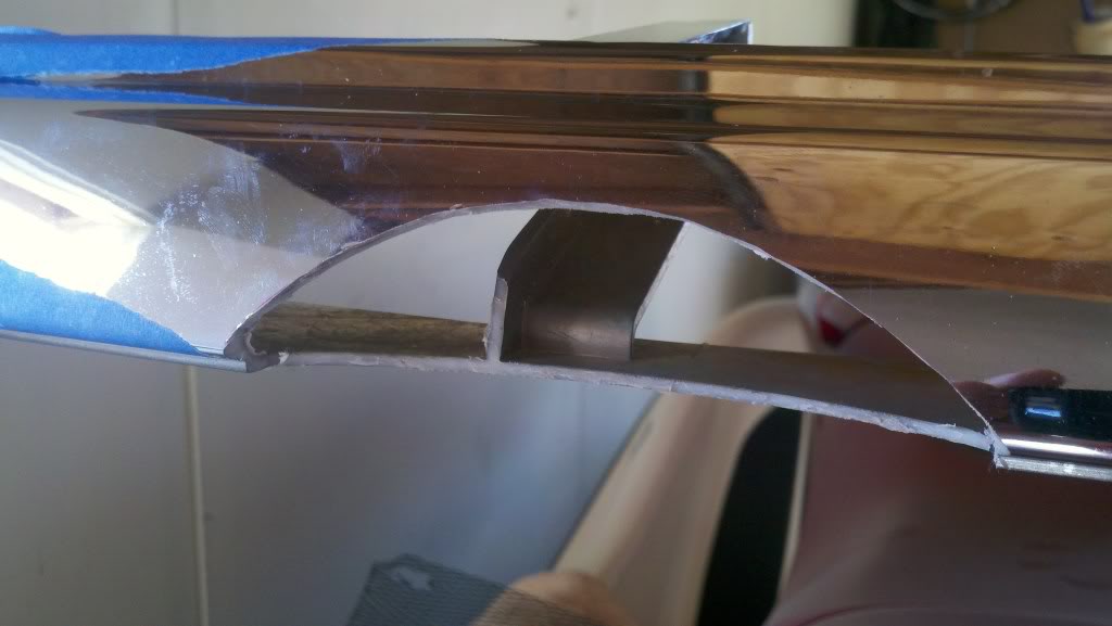

Next it was time to cut the top of the grill in order to make room for the PIAA 520's:

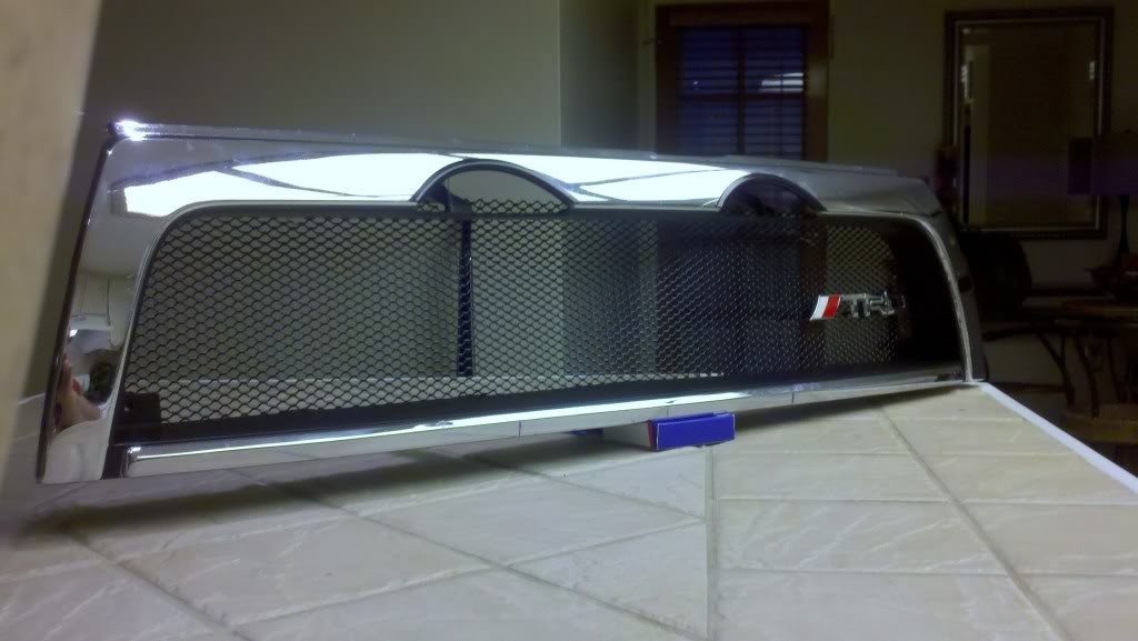

Finally, after some painting and cleaning, here are some pics showing the finished grill:

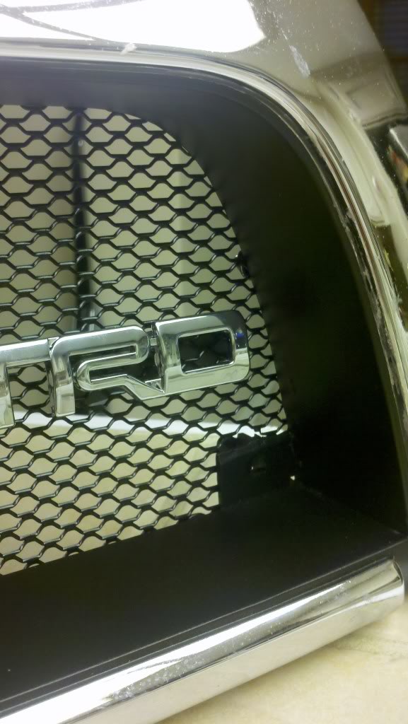

To secure the mesh firmily to the grill frame, I glued some studs with epoxy to the grill frame:

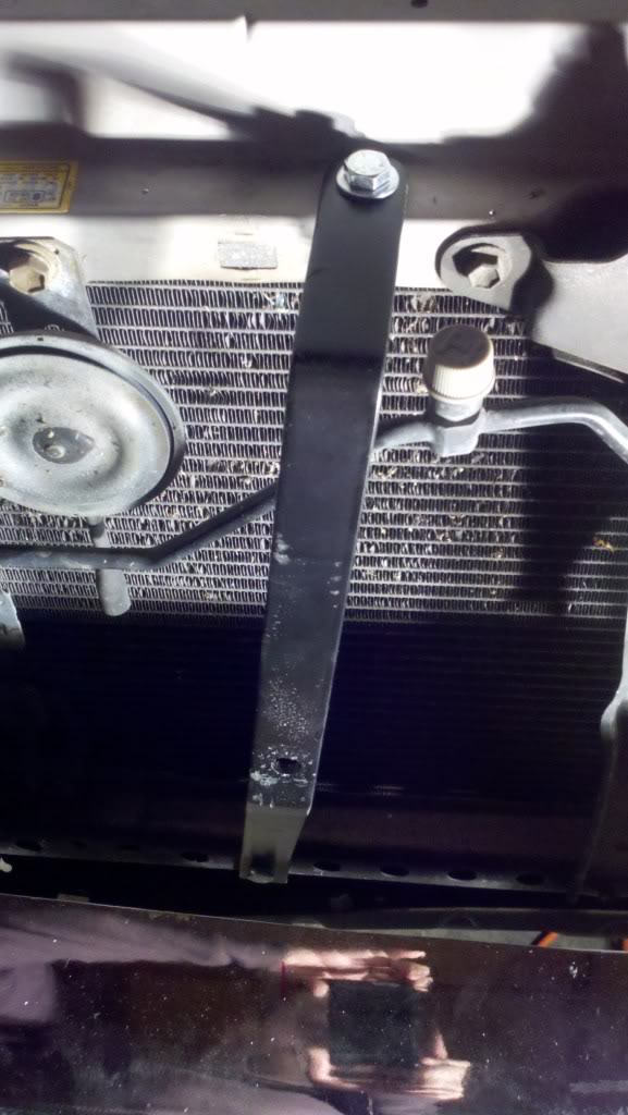

Ok, here is a litle update, I just got done making the brackets for the lights, They seem like a little to "overkill" but I want it to make sure that they would not vibrate once installed. I should be done with installation tomorrow, weather permiting! Here are some pictures:

Nice clean work. Expanded metal is a tough sell over mesh lath for 10x the price.
Two questions for you - What tool did you use to cut the semi-circles in the grill, and what are the trim pieces around them?

Good looking mounts... nice and beefy...

Thanks "jbtvt" for your comments! to answer your questions; the two semi circle opening on the grill were cut using my trusty dremel tool. For the black trim pieces, I use regular door edge rubber trim strips (from Pepboys). You know the ones you put along the door edges to prevent dents or paint chips.

Looking good so far..can't wait to see the end result.
I would suggest tying both the brackets with horizontal bar or bars which reinforces each light mount to eliminate any vibrations and movement.

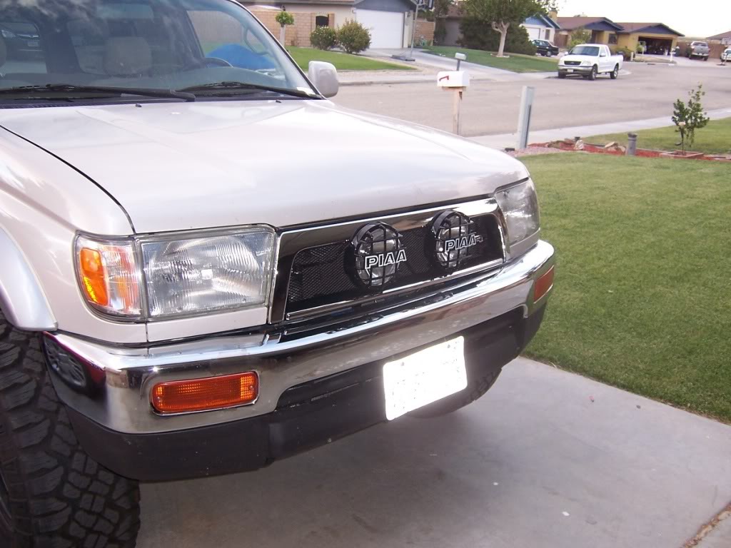

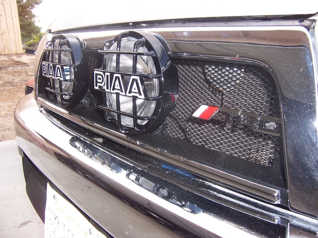

I just got done with the Satoshi/PIAA 520's MOD in my truck. Once again the credit for this MOD goes to “Blcktpgsr’s. It was from his truck I copied the idea of combining the Satoshi grill and a set of PIAA 520's. I hope you guys like it. Well here are the pics:
Well, I think the MOD came out as I was expecting. Next add on will be a set of PIAA Fog lights. Thanks for all your comments!
