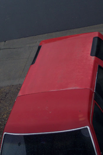

heres a pic of the top of my truck....
im not sure where id mount the rack, since i see no rain gutters.
Attached Thumbnails safari rack/ basket rack for my 4runner-trucktop.jpg

You need the crossbars and the gutter mounts, and the rack will hook onto it via it's hardware.
You can use either Thule or Yamkima crossbars and gutter mounts.
They will both work with the Yak rack.
I have a free server that my website is not on, and I will upload some pics to it soon, so you can see Todd's rack.
He has also customized it much like I have mine with an ax mount, shovel mount, and Hi-Lift mount.
Also to give you an idea on this rack, look in our Tech section here and look for my write-up in the Off Road Enhancement area for my rack.

i think that you can buy those rails that factory roof racks have and install them on your roof...or..something ... not sure though..hah

The Yakima Load Warrior also sits very well, and lower on factory rails than aftermarket crossbars.
There are a few members here who have the Load Warrior mounted with factory rails.

It is a good deal if it has to foot brackets and in good shape.. I paid about $125 for mine with out the mount feet.. For a 1st gen Runner, I would just seal it, and bolt it tight thru the roof.. Use acorn nuts and stainless hardware.. back it with a large fender washer..

thats what im thinking, just bolt the sucker to the roof.

Oh.. I did see a page with a guy that had a pick-up that bolted the basket itself to the roof.. the brackets that come with it are very well suited for this.. and it would be very low (it would sit on the roof in fact.. If I had a glass roof, I would find a way to bolt the Surco crossbar to the roof, and mount the rack to that.. that way you are off the roof enough to attach stuff with straps to the slats and it would look a little better (IMHO)

it would also disperse the weight better
