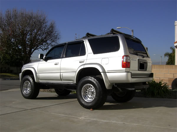

To clarify:
For a specific wheel width, (not diameter)... a HIGHER back spacing translates to more of an inset rim which also translates to a HIGHER, or more positive offset. A LOWER back spacing translates to more of an outward pushing rim, which also translates to a LOWER or more negative offset. The lower the offset number, the more lip or dish you get.
Focus on the depth of the dish of the following examples. Without the additional 40mm added to the fender flares, the rims in the first example will protrude out of the Limited/Sport edition flares just a tad.
16 x 8 neg 20 offset: RUMBLES' awesome truck:
16 x 8 ZERO offset: Hourt's awesome truck: Zero is more positive than neg 20, and hence the rims do not have as much of a dish and do not protrude out of the fender flares.
I hope that clarifies things for some folks. Sorry to thread-jack Kevin.
Relevance: The proposed 16x8 with positive 10 offset should work just fine. All of this hodge-podge I posted is for us nit-picky people that like things a certain way... LOL!
