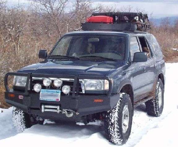

I have the Yakima Load Warrior.
A lot of the stuff on it I did myself such as the shovel and jerry can mount.
The Hi-Lift and axe mount are store bought.
http://www.pnw4runners.com/runs/41203/21.jpg
http://www.pnw4runners.com/runs/41203/5.jpg

That loadwarrior looks the business. I checked one out at REI the other day. Two stupid questions:
1. Do you get much windnoise with it?
2. How did you wire the lights (where did they enter the body)?

Chris's rack sits back further than mine, but this is how I wired mine.
I get no noise with my rack.
I use to, but that was before I had stuff on it.
I also have the Yakima "Wind Jammer", a little wing that sits up front that disperses the flow of air.
