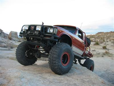

Beadlocks
The more bolts the better on a beadlock "style " wheel...
The less likely you are going to have air leaks....The street
version are just that...for the street...not much good for off-road.
I have 32 bolt Allied wheels and they have not lost a single pound
of air...They have a very well built wheel and the tire seats and
attaches to the outer locking ring extremely well....but are not
D.O.T. approved...
Attached Thumbnails rock crawler bead lock-johnson-valley-jan-4-006-custom-.jpg
