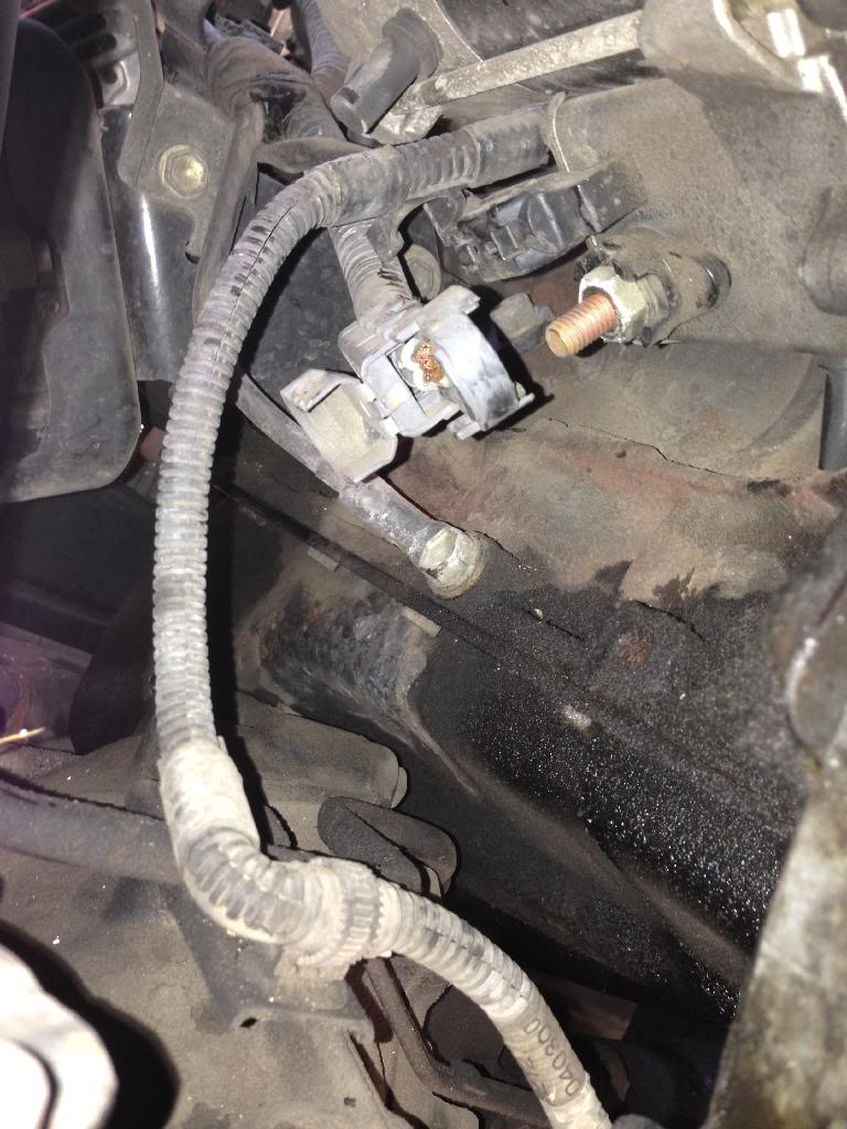

FYI - here's the spot where the positive lead attaches to the starter. The end of the cable is sheathed in a protective plastic hatch. Flip the lid open to the hatch to expose the nut that attaches the cable to the threaded post on the bottom of the starter.
The negative cable attaches to the engine block just across from the starter post in that picture. It's attached by a bolt.
The hardest part of the job was cutting through all the wire looming and electrical tape that held all of the other electronic wiring together. Once everything was stripped off I was able to pull the old + and - cables out of the mess and then spent quite a bit of time redressing everything with new electrical tape and wire looming.
