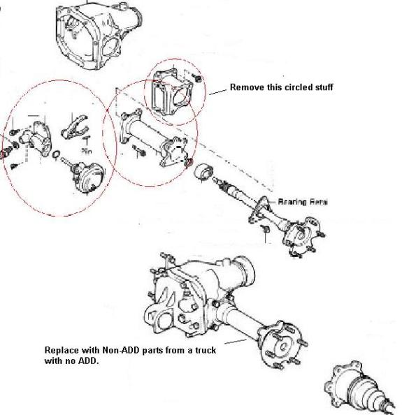

There really isn't any need to remove the ADD, the things aren't prone to failure. But if you want to, just unbolt the ADD clutch case and short axle tube from the diff case, and replace them with a long axle tube from a non-ADD truck, or so I've been told. I *think* the original axle ("side gear shaft") is good to go too, but you might double check on that.

And don't forget to remove the vacuum mechanism (just to be neat) and to tie the two wires together for the switch on the ADD mechanism so your 4x4 light still works.
