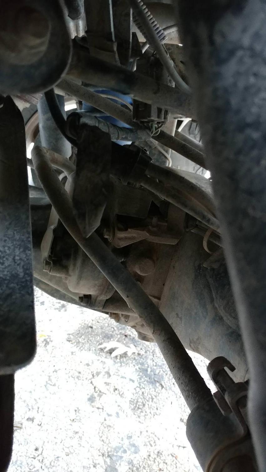

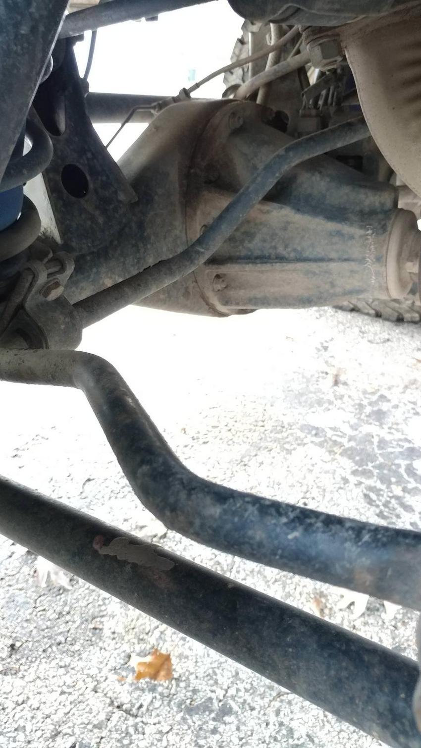

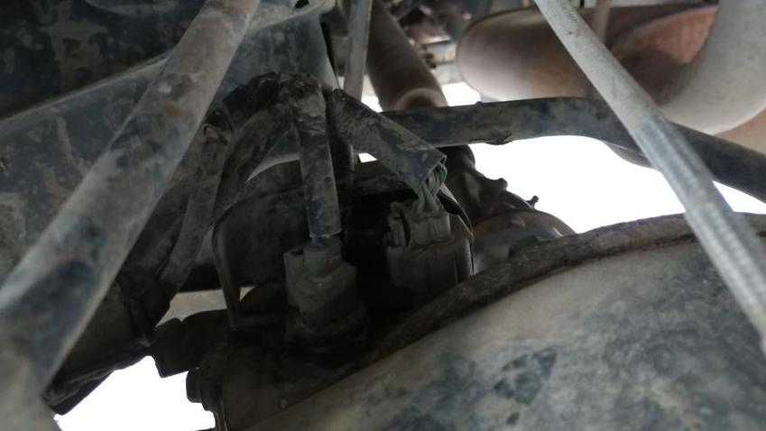

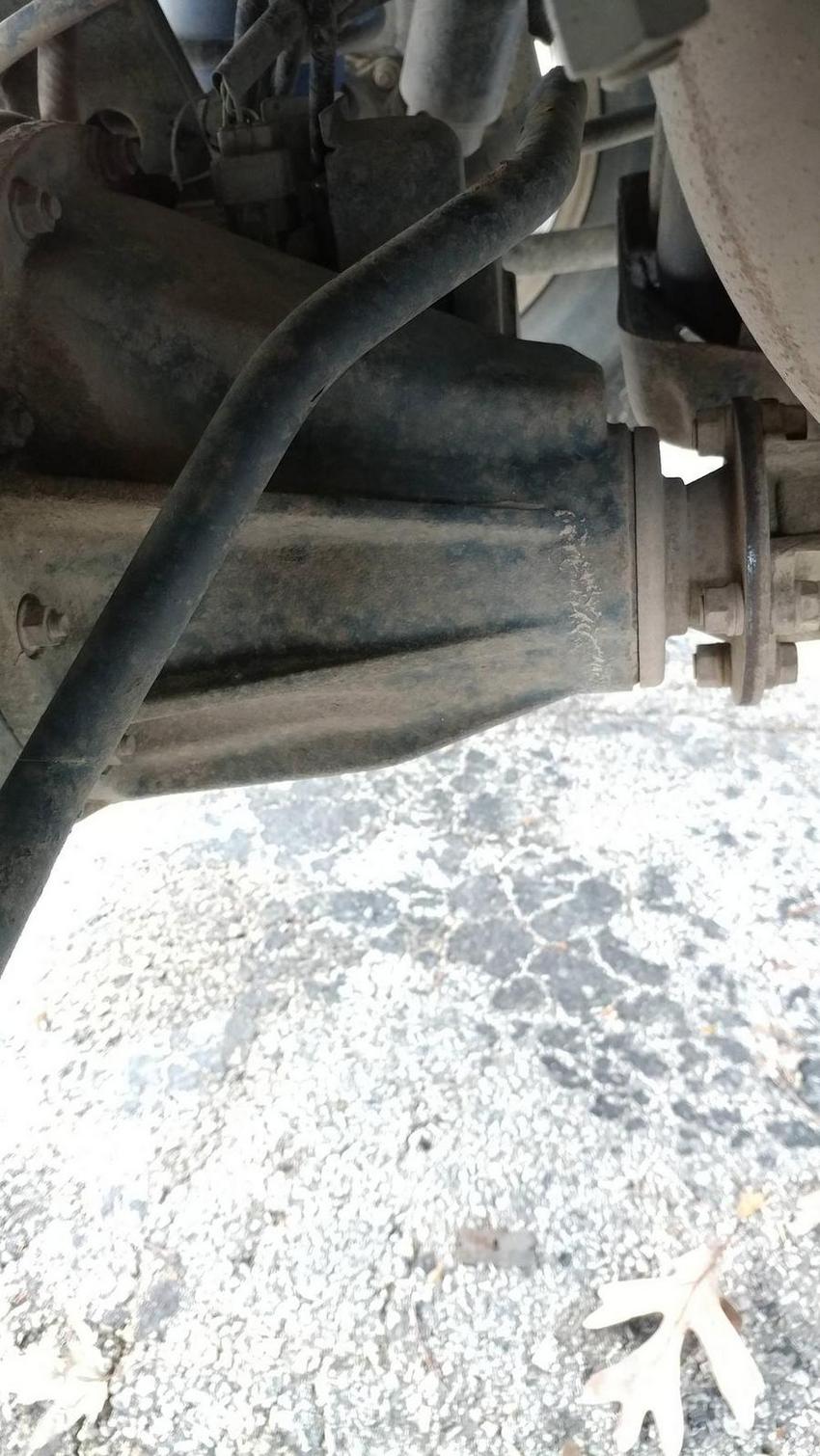

can someone post pics of how the rear swap bar routes around the rear diff on a 4Runner? Thanks.

Elocker dif- regular is the same...
From the left- gas tank on far left of pic

From the right

From the right

From behind the dif

Thanks Hab. It appears I put my sway bar on upside down, and that explains why it was a bear to line up.
