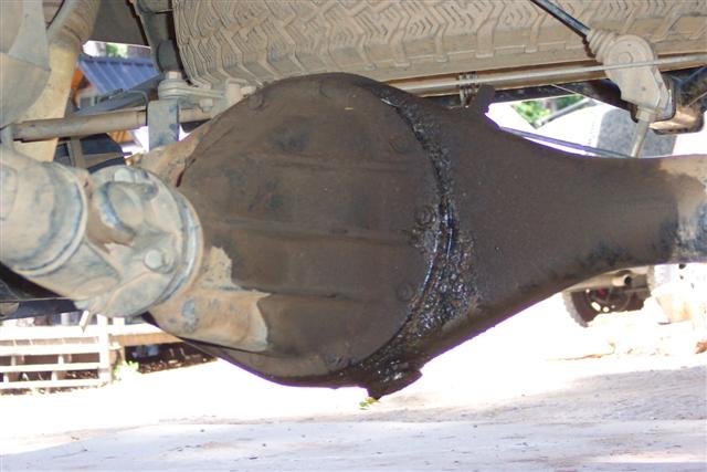

My rear diff is leaking oil, so im planning to replace the gasket. This looks like a fairly straight forward repair. Any tips on this or should i just have at it?

when you pull the axles make sure that you don't let them sit in the housing, pull them out all the way and stand them up, i just pulled out my third a few weeks ago to weld the pinion gears, and i just used red silicone to seal it up, no leaks and it now has 3 wheel drive

Like Superjoe said, don't worry about a new gasket. Just make sure both of your surfaces are good and clean and just smear a thick coat of sealant around it. Works just as good and cheaper. It'll seal tighter and you don't have to worry about the gasket blowing out again.

Ok sounds good. Thanks for the info guys. I was thinking id use the gasket with the silicon stuff since i already have the gasket. Sound like a good idea?

No, use one or the other, not both. Might as well replace the axle seals while you're at it.
