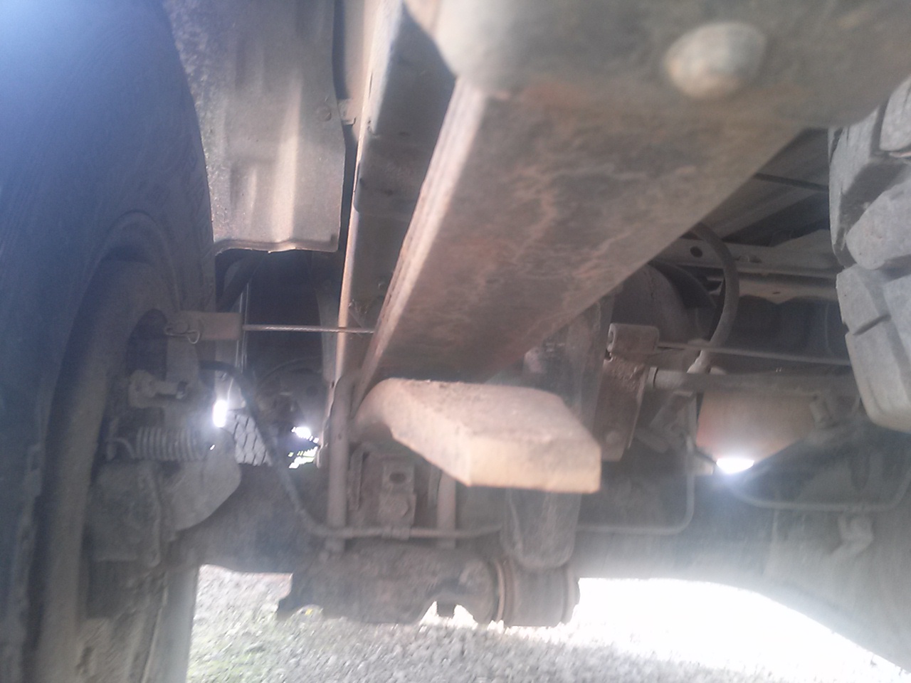

And when you looked into it, was your ebrake cable sagging or taut? I looked at hers and it's taut, no sag. I'll upload pics of it and the bellcrank here in a min.

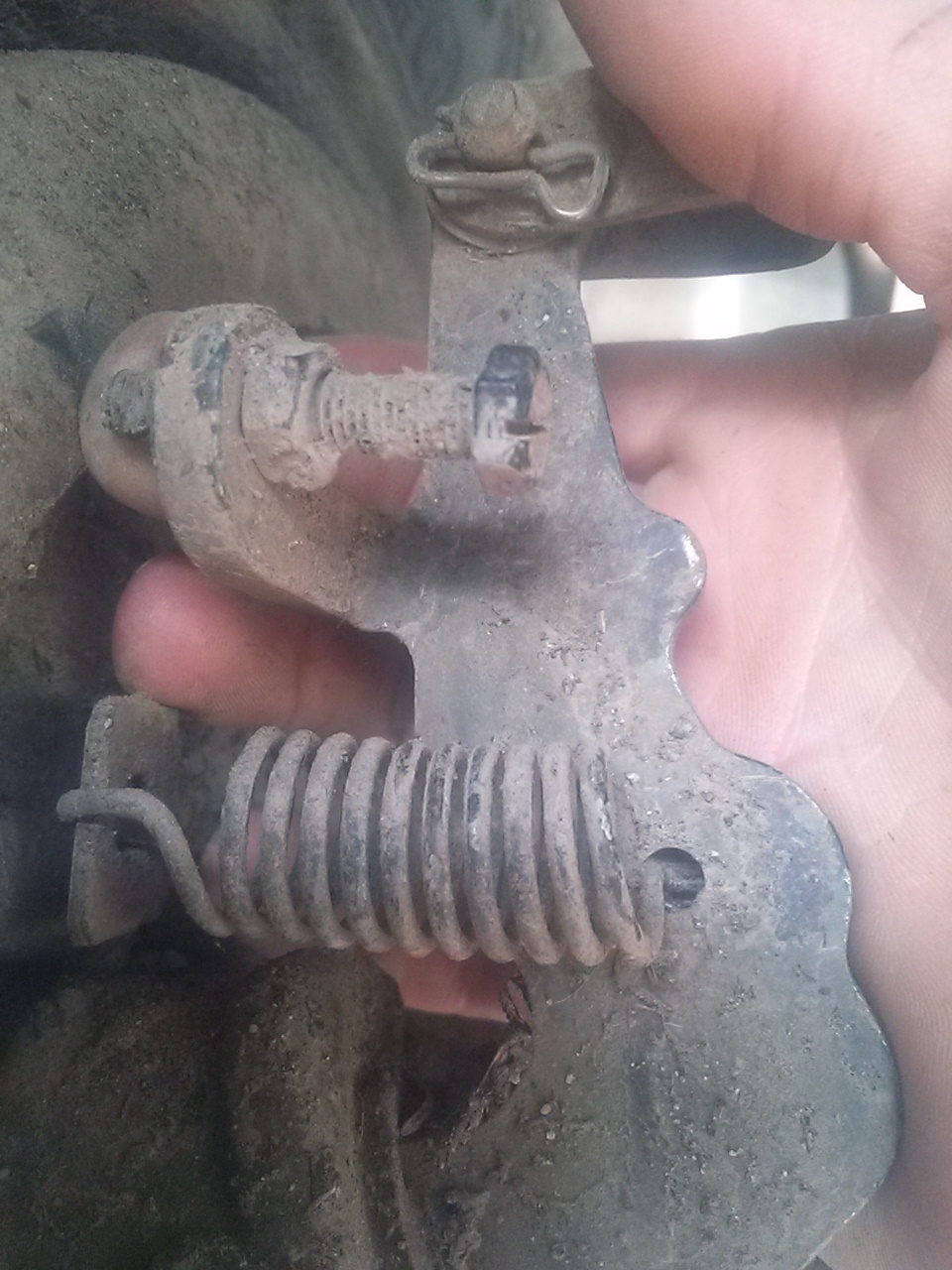

Ok here's a pic of the cable and the bellcrank. I assume that part is bellcrank. I put my finger behind that set screw so the gap can be seen, make sure it's normal
There should be no gap. If the bolt on the bell crank isnt resting on the backplate, the shoes arent releasing completely. Check the pivot point between the left and right cable. It balances the force between both sides. On mine the pivot bolt had rusted up squeezing the nylon bushings both top and bottom. I should have taken pictures but it required grinding off the rust from the bolt shaft and repacking with silcone grease. Just to be clear. There should be about 1/8" of play with that bolt. It should sit on the backplate but have 1/16"-1/8" of play before you feel resistance.
The pivot bolt is the one bolt that is pointing up. The nut is welded to the rear axle.
