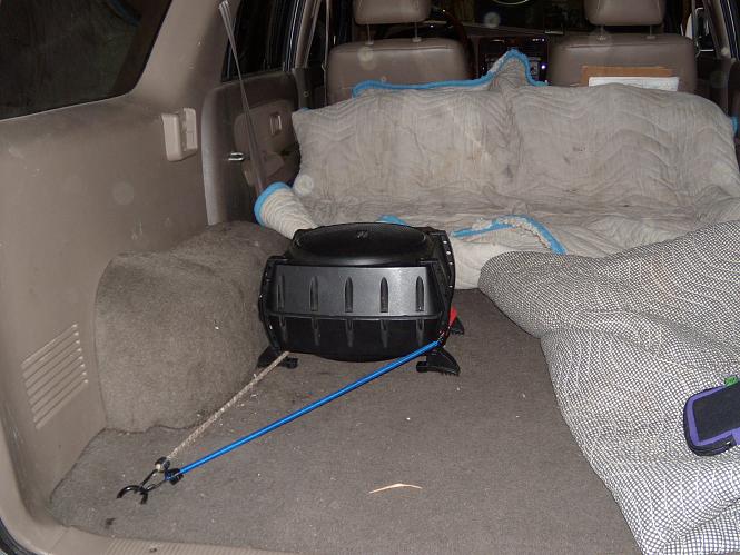

I am searching and came across this old but great thread. I have the Infinity BassLink in my rear cargo area and now want to mount it horizontally-(flat if you want to describe it that way...)
However I bought my BassLink used and it came without the horizontal mounting brackets (there should be 4) and I need 2 more long- threaded (at one end only) screws to do so.
If any of you are still around-still have your BassLink pieces-have no intention of ever mounting it other than vertically as pictured above-and would want to give or sell me your extra pieces I would love to have them.

I'm in the same situation you are, Ron. I bought mine used, as well, and didn't get the volume control and only a couple brackets. I made my own, so when I get home from the long weekend, I'll check to see which ones he sent me. I think they're the vertical ones, but if I have the horizontal ones, you're welcome to them.

toytech hooked me up with the horizontal brackets I was seeking and the sound is better already and I like the lower profile flatter to the floor. Gives me more options with my cargo area and room for the pup.
thanks RobD for your help and communication along the way. I briefly even considered just buying another unit used on ebay just to get the brackets... but the prices were always jacked up beyond belief.
a quickie snapshot with my usual cargo blankie in back for the dog's sprawled out enjoyment. She's a bit irritated with me we have not been to the mountains much lately so I owe her big time...
