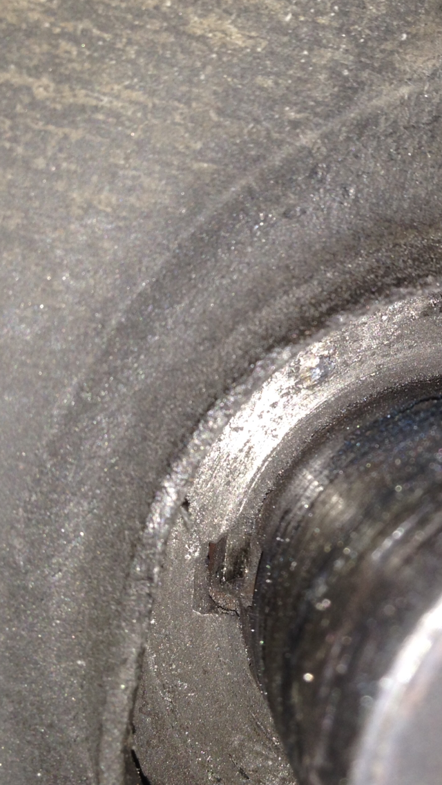

Most times the for one reason or the other the key way or the key itself is worn
Could be it was never torqued to specs
Wrong size key was used because it was close enough
Over time it moves a little till it gets real sloppy and just shears right off allowing things to spin free.
At this time the crank and the pulley are to the point it is cheaper to replace

I had a very similar experience the year before last. My timing belt and water pump had been done right before I bought my 4Runner. The mechanic didn't use a new crank pulley bolt when he reinstalled it though. That bolt has to be torqued down to like 180 ft. lbs. or something. The bolt backed out after a couple hundred miles, and the pulley slipped forward on the crank causing the woodruff key and crank end to completely wear down. It was either tear the entire engine apart to replace the crank, or buy a new engine. I ended up buying a JDM engine off of eBay with 40k miles on it. I had a friends shop install the engine for me. Paid $1595 for the engine shipped, and $1300 for the shop to pull the old engine, swap the supercharger onto the new engine, then install the new engine in the 4Runner. Ended up costing me less to go that route and I now know that I have an engine that will last for years to come.
