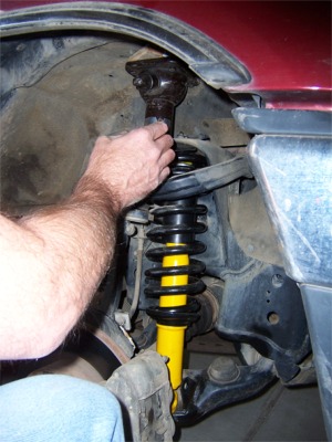

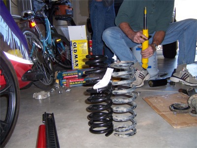

So I ordered all the parts a couple weeks ago: tundra front coils (with out top out spacers) w/ OME N91S and OME 906's w/ N86's. And, after 5 hours of wrench today, its done. I got a solid 2" in the rear and more than 2" in the front, but that is with out an alignment. The ride is really nice. I've only driven it from Ft. Collins to Denver which is about 70 miles and it feels much more solid and stable. The hardest part of the install? The spring compressers were pretty scarey, and the rear shocks came out fairly easy, but taking the rear coils out was tuff. The axle has to come down pretty far the get the coils out. The high lift jack came in handy then. All in all, I'm pretty pleased. I would like to thank this forum, for, without it, I would have been as smart/stupid on spending the money and installing this lift.

Attached Thumbnails Phase 1: Lift: Complete-lift-resize100_1771.jpg   Phase 1: Lift: Complete-lift-resize100_1781.jpg   Phase 1: Lift: Complete-lift-resize100_1774.jpg

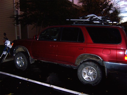

Alrighty, here are the before and after pics. The back is loaded with about 100lbs of crap in each pic.
-Simon
Attached Thumbnails Phase 1: Lift: Complete-100_1354.jpg   Phase 1: Lift: Complete-100_1786.jpg

Looks good! Did the alignment help level-out the lift or should I consider getting some taller coils for the rear?

Well, if the alignment did level out the lift, I can't tell. The picture of the lift is taken on a slant though so that might scew the photo a little. And a question about the alignment. I brought it to Meineke and they spent about 3 hours on it. I got a copy of the print out and everything is within spec, how ever, it pulls to the right a little bit and the steering wheel is off center. They said that the tires might have something to do with it and they offered to rotate them to see if it would help. I looked at the tires and the front passenger side a quite a bit more worn than the front drivers side. Can that make that much of a difference?
