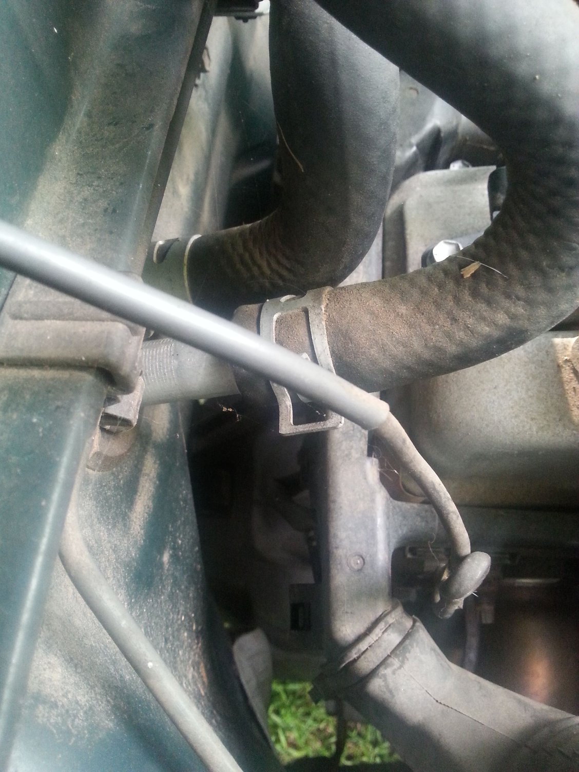

lights back on.
Does anyone what these are called

Old Apr 8, 2016 | 04:53 PM
40vern's Avatar
Joined: Sep 2012
Posts: 77
the thing in the picture that I posted that is grey, I hooked it up to the battery with some clips and it make a clicking noise. the one that is black and has allot of rust around it it did nothing. but I may not make a noise at all

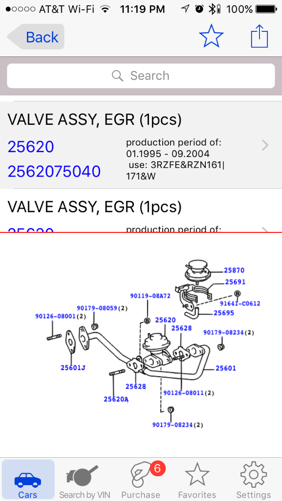

does anyone have a clue where the erg valve is located? I cannot find it anywhere. I was going to buy a new one since rock auto list one however I can not find it on the engine any where
Old Apr 27, 2016 | 10:17 PM
beast760's Avatar
Joined: Apr 2016
Posts: 2
Egr should be towards firewall passenger side of valve cover
Old Apr 27, 2016 | 10:20 PM
beast760's Avatar
Joined: Apr 2016
Posts: 2
Old Apr 28, 2016 | 04:35 AM
40vern's Avatar
Joined: Sep 2012
Posts: 77
Originally Posted by beast760
I am sorry but I don't see anything their
Old May 3, 2016 | 06:21 PM
40vern's Avatar
Joined: Sep 2012
Posts: 77
In the pocture the little square thing under the wires. Well that little box I took it off and connected it to the battery. I replaced it with one from the junk yard. The one from my truck would not click at all. One from the yard will click. The serial numbers did not match up but I will give it a try.
