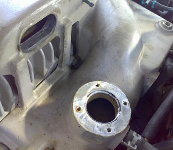

I kept hearing a hissing sound near the supercharger bypass valve where the L-shaped metal tube would meet the supercharger manifold. Spraying starter fluid in that spot would affect my idle significantly.
I confirmed at Magnuson that it is supposed to be sealed.
So, I unbolted the bypass assembly and pulled it out.
The O-ring near the actuator is toast (most of it was broken apart by heat?).
The other O(val)-ring is still together, but it doesn't seem to seal well.
So, I'm off to the hardware store to find a matching diameter O-ring.

More pics of the bypass assembly
I also cleaned up the build up (looks like dissolved o-ring or RTV) on the actuator flange side.
It only requires a little elbow grease and 5mm allen wrench to remove 4 bolts.
Use loc-tite when re-assembling.
I'm going to put a little RTV on the beveled surface for assurance that it'll seal near the actuator.

I think you'll find that you found the source of your P0171 code now.

More pictures of the clean up and o-ring installation.
I used the 2nd largest and thickest o-ring in the assorted pack I purchased from Home Depot. Put some lithium grease on it so it doesn't pinch on re-installation.
I added some Right Stuff RTV on the flange to ensure it seals.
Also add some loc-tite on the bolts.
No more leaks in this area. My idle is higher with no load now (at spec ~ 750).

I verified my fuel injectors have continuity with the main harness. Fuel is being injected in each cylinder.
The gasket for TB is installed correctly and appears to seal.
I did notice the front stud for the supercharger to block was a little loose.
Hopefully I can find an adapter for my fuel pressure gauge.

Well, I am very happy now, its been over 100 miles and over a week of stop and go traffic, the dreaded P0171 code is finally gone!
That still may not mean its not still lean, but, I will pass emmisions now. And if the problem comes back that will be the first thing to look at. I used a skinnier O-Ring because it would not go back in, even tried to force it in. was a no go.
Im kickin my self in the ass . turned out to be a dang 59 cent o-ring, and i spend 300 on a MAF

UPDATE from 11/04/06:
The P0171 code kept popping up after each hose replaced or gasket replaced.
I then started to see P0125 code with the P0171. So, I replaced the O2 sensors (I replaced both when I probably only needed to replace the front) and I don't get the P0171 nor the P0125 code.
So, the CEL is now solved. However, I think I'm still running lean on moderate boost. The buzzing or ticking noise I hear inside the truck is still present (it sounds like it could be a leak from a nylon line). You can feel the pulsations of this buzz in the fuel return line and pressure line at the FPR (aftermarket). I have determined that the nylon tubing on both the FTC and boost gauge do not contribute to this noise.
I'm going to swap out the FPR with a stock one to see if the noise and the WOT issue are solved.
