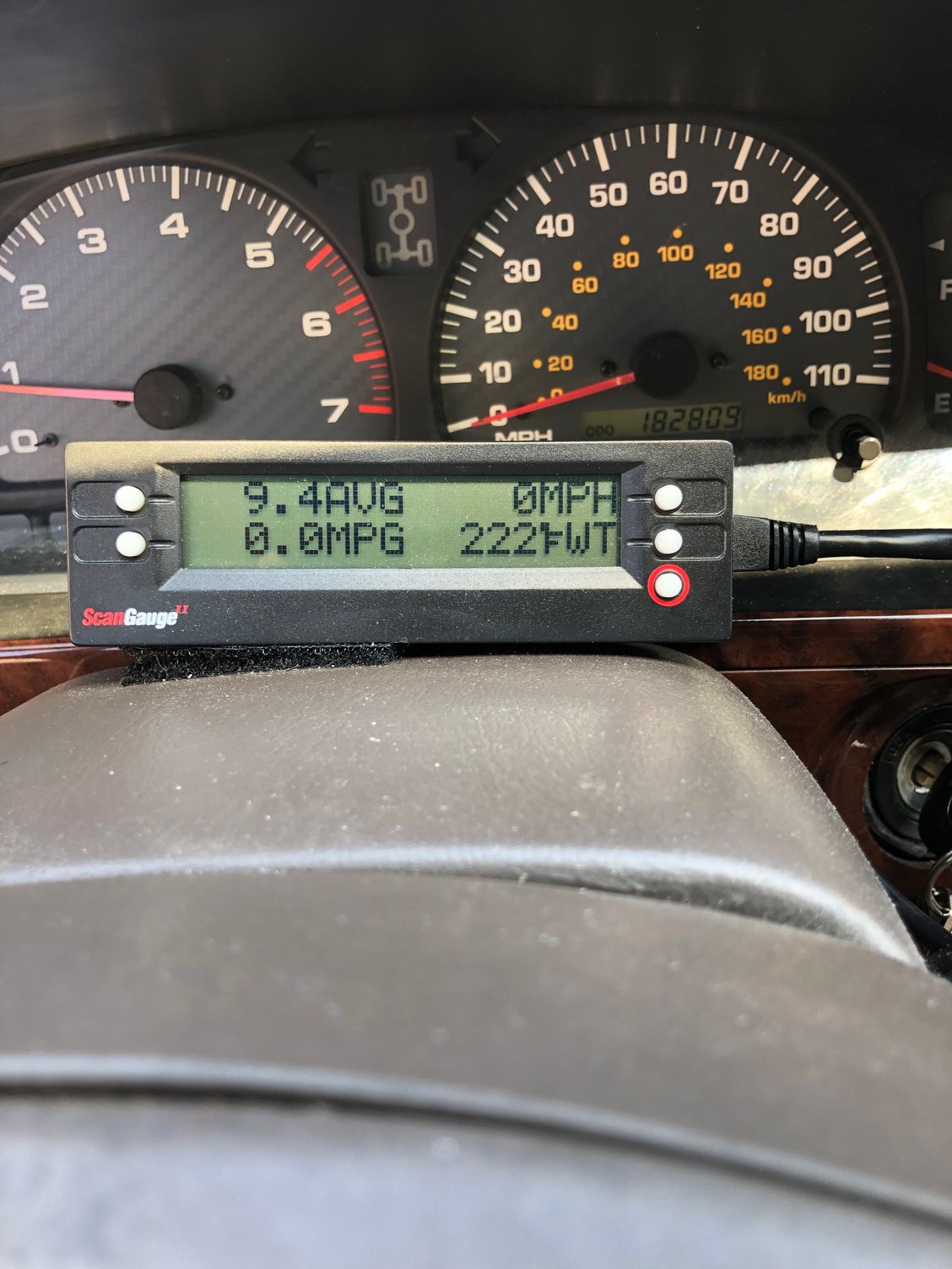

What temps are you guys running?
I installed an ScanGuageII earlier this year and have really gotten into monitoring running specs. A handful of times in the sun with a/c on max I could get the gauge needle to creep up, but that was before digital monitoring.

I just got out of some bumper to bumper traffic. The highway it went was 227*, then I put the windows down, killed the A/C, and blasted the heat.
this is with fresh coolant, new rad, and new hoses. The water pump and thermostat have maybe 50k miles on them.

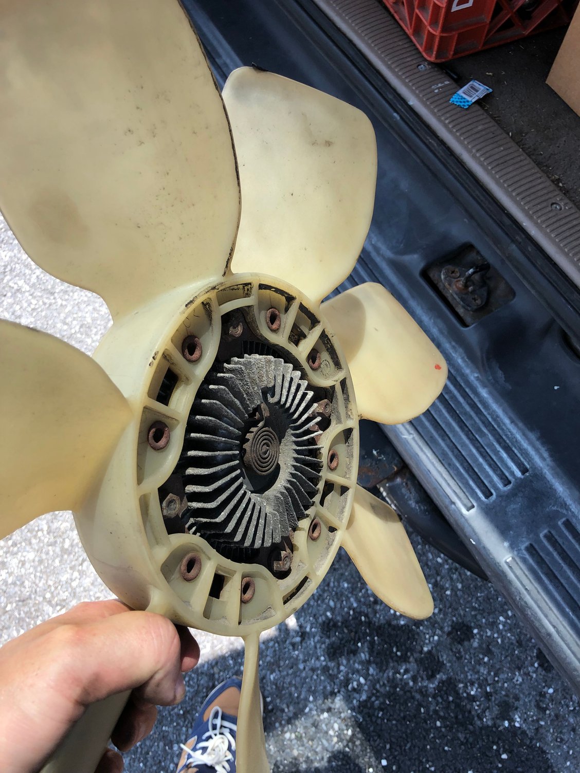

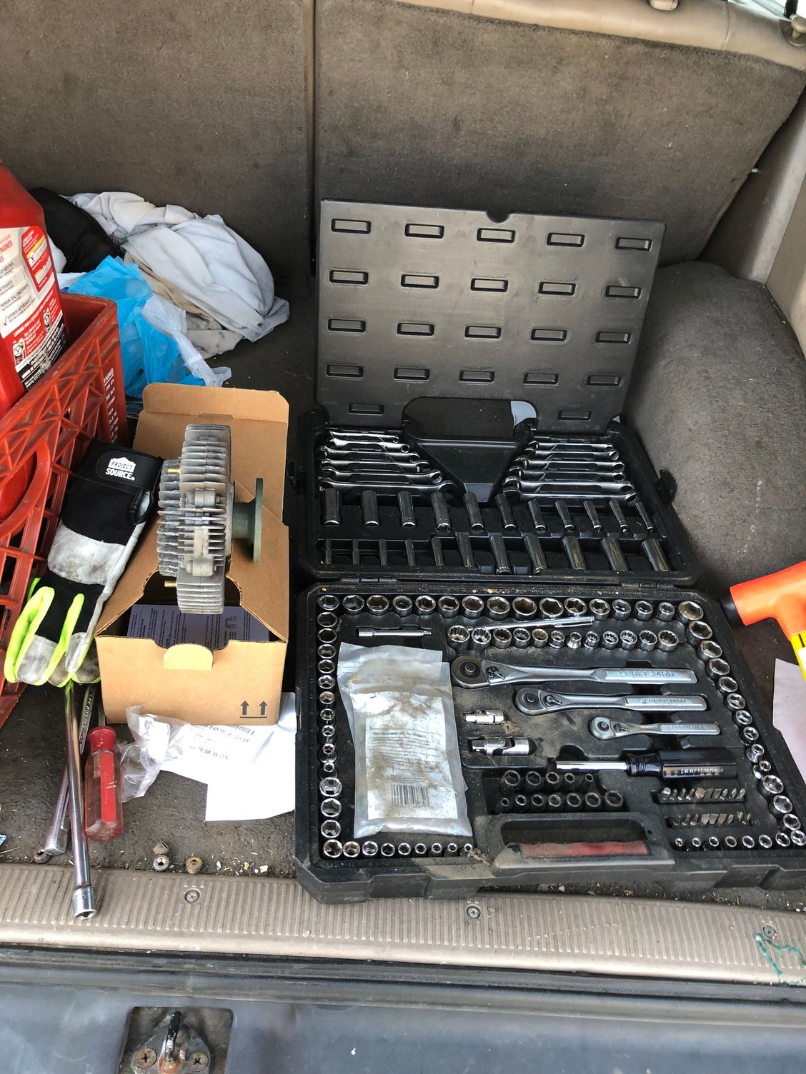

I popped the hood after driving and gave the fan a twirl and it just free spun. So a little parking lot detour and repair has my idling in traffic with the A/C running topping at 191*
30 minutes in 97* degree heat start to finish. I think I lost a few pounds sweating.

A few days and a few hundred miles later, the fan clutch was definitely a problem. The temp has never gone above 193* in a bunch of different conditions.
the downside… all that fan drag now is KILLING my fuel mileage 😓. I’m struggling to break into the 20s.

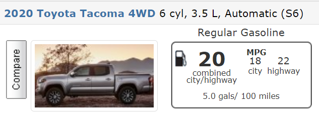

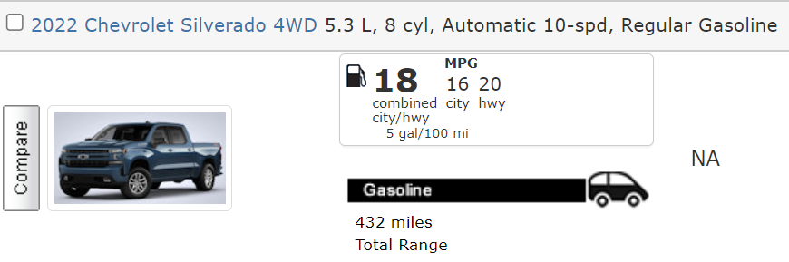

Good point. I guess a better comparison would be a more modern Tacoma. If we're going to go with data and not anecdotes, here's the comparison.
I have a friend who recently bought Silverado, somewhere around a 2015, who claims to get around 24 on the highway, and still over 20 when he's got his slide-in camper on the truck. His is the V8 that'll drop to a V6 when you want. I didn't look hard enough to find that option on the website I looked at....
What I see with a lot of people is a negative view of full-size trucks as being wasteful gas hogs. Those same people are at least a bit more ok with, if not completely accepting of small trucks like a Tacoma. When in reality, the difference is minimal. And once you start towing, the full size trucks typically get better mileage than a Tacoma, because they're big & powerful enough to not have to work so hard.
