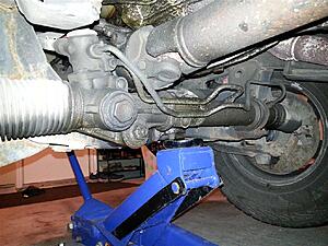

But wait...if only one control arm is bad, and the ball joints are good, then why am I experiencing the exact same wear pattern on both tires? Hmm, lets look around some more...
Oh man...looks like my rack is leaking too! But my tie rods still feel tight with no movement when yanking on them...what gives?
Could the rack internals be shot, causing this type of wear? Or could that one control arm cause BOTH tires to wear out?

Yes, my truck seeps oil like a sieve but I suspect my rack is leaking because of the oil accumulation on the bottom of the boots; I don't see any accumulation on the LCAs or forward of the rack.

I got up close and personal with the steering rack, put my nose to it, and the oil that is dripping off of it is motor oil, and not PS fluid. I didn't do a taste test so I might not be 100% accurate on that one.
