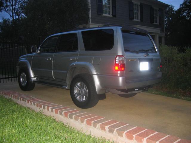

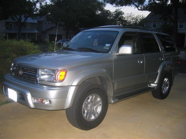

The new beach truck. Going to have a good tech go through it fully. Get a good roof rack and recovery gear, get the undercarriage coated with this stuff http://www.eurekafluidfilm.com/appli...utomotive.html (open to suggestions), weathertech mats, Okole covers, rod holders, and go catch some big fish on the surf!
I know this has been asked before, but can anyone give my general guidlines on how much wider of a tire I can go with stock wheels w/o going with some nutty spacers?

265/75/16 stock.

As for the biggest tires you can fit stock, 275's fit fine usually. 285's will fit but will rub a little, but usually minor trimming/lift will fix that.
Bigger then 285 needs 1 - 2 inches of lift and trimming.
So if i was you i would go for the 285, in fact thats what i will get if i decide to get bigger tires. I don't plan to lift more then an inch, maybe 2.

Thanks fellas. After driving the 4runner around for a day, I think I will go with a new suspension, and since I'm at it, my as well do a mild lift. I talked with Steve at Sonoran; he recommended the 7.2 for my use. Hopefully 2" wont be too extreme.
With the added height, 33s (285/75) sound like the hot ticket. The rig won't see daily commuting or anything so the bigger rubber would be nice for the sand, I think.

Yep, if you are getting the 7.2 then 33" in 285 will be perfect. Might need just a tad of trimming for when you are flexing but nothing too bad from what i hear.
