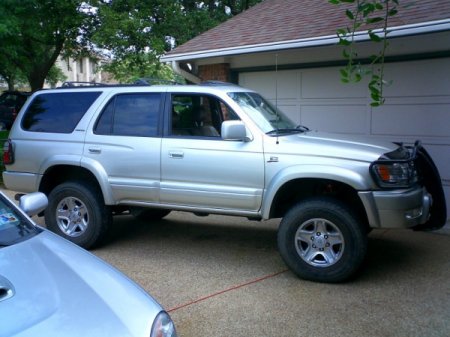

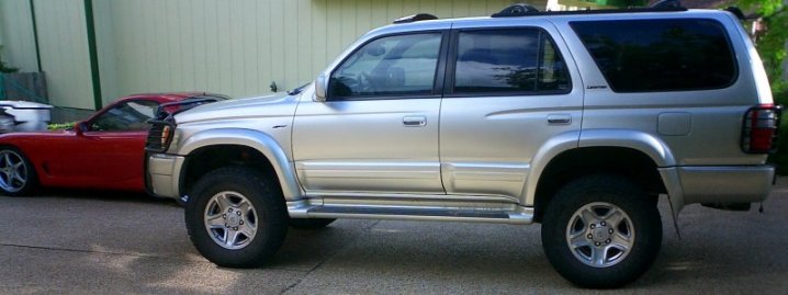

Another shot from the other side
I need to take the running board off the driver side....

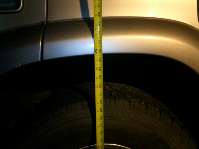

Measuring before the installation.
After letting the suspension settle after OME installation, I measured about 37.75".
J

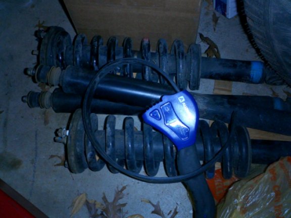

Handy tool that helps loosen the locking nut on the shock hat.
I bought mine at Autozone, but I believe Walmart has a set for cheaper than $5. I paid $7 for a mine (2 sizes).
J

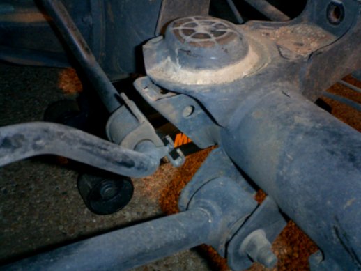

I disconnected the rear sway bar brackets that mount on the axle housing.
I believe it's 10mm bolt heads (2x per bracket) and they hook into place from the bottom to top.

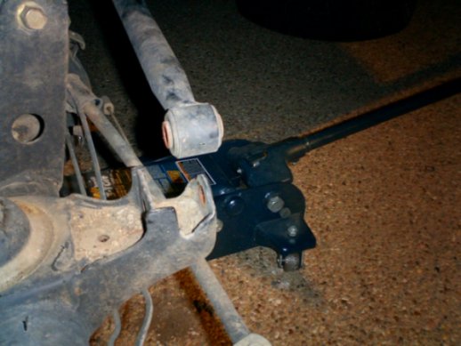

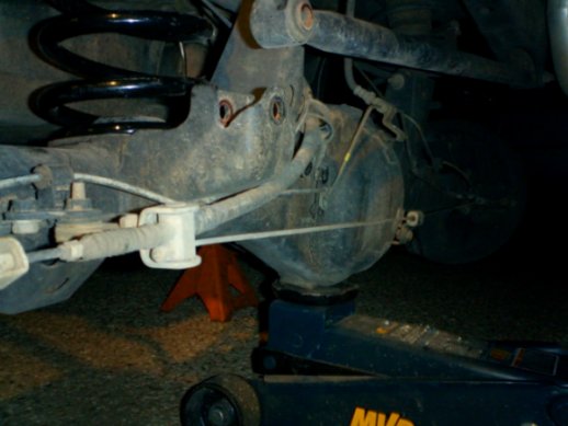

I was trying to show my set-up for lowering the axle housing to the ground so you can remove the stock springs. The manual calls for chains to bind the spring to the axle housing in case it "pops" out. I figured if I lowered it slow enough, it wouldn't pop out and it works.
I used heavy duty jack stands for the frame near the rear fuel tank.
I supported the axle housing with a 1 ton jack.
Provide good enough clearance so you can lower the axle housing enough to pull the springs out.
NOTICE: Before you disconnect and/or lower the axle housing, make sure you disconnect the brake line brackets on the axle housing. I believe I used 12mm for 4 brackets (one on each side, two near the top of the housing).

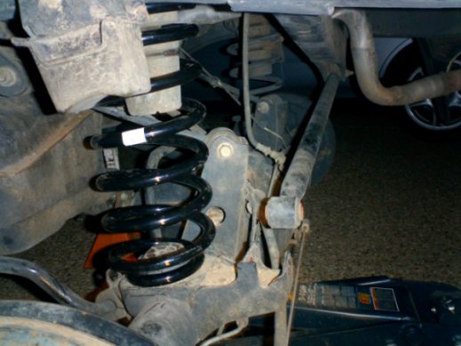

Here is the driver side OME HD spring in place.
J

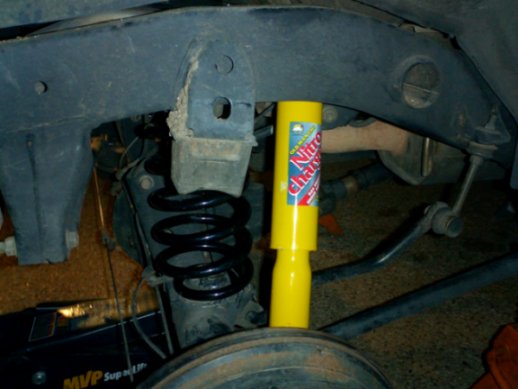

Here is the passenger side after I replaced the shock and spring.
It's very straight forward. I used Liquid Wrench on the locking nuts for a few days. I doubt it helped that much as I still had trouble with a cheap impact ratchet or my gloves. The strap wrench I borrowed from a neighbor was saturated with motor oil and the metal shaft of the tool bent the shock body.
I tried the cheap plastic strap wrench from Autozone.
I surprised myself by the ease of breaking loose the locking nut with the strap wrench on the shock body and breaker bar/big wrench held in place with my hand (passenger side) or against the frame.
It rides high, but surprisingly stable. I'm used to sports cars, so the higher center of gravity is a new sensation for me.
It was great during a little offroad break I took during the rain the other day.
I can't wait to try towing stuff with it.
The rear stock set-up (~88000 miles of age) was no good when I towed my friends IS300 on a 21' trailer. Talk about the tail wagging the dog!! I couldn't drive faster than 45mph.
J
