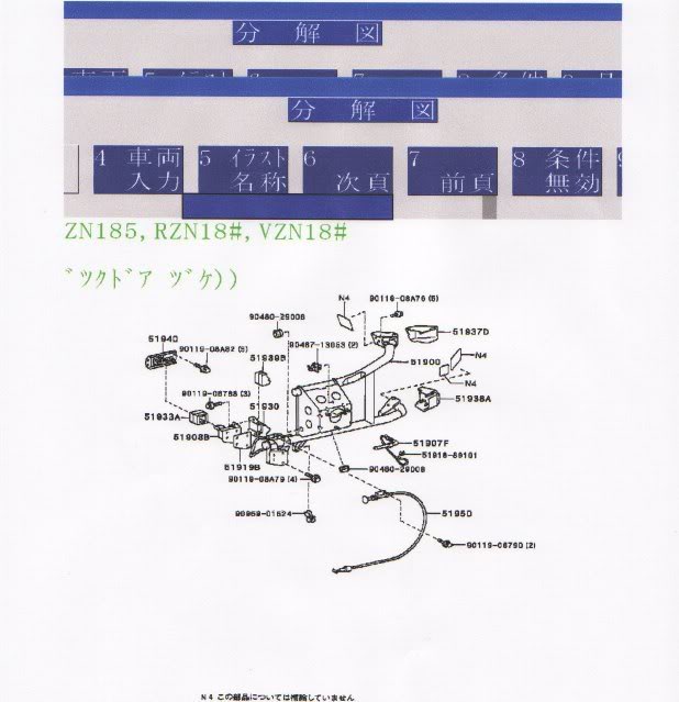

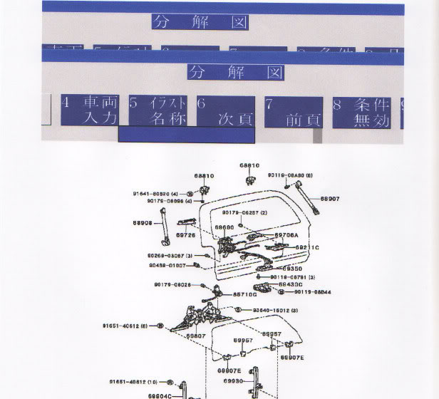

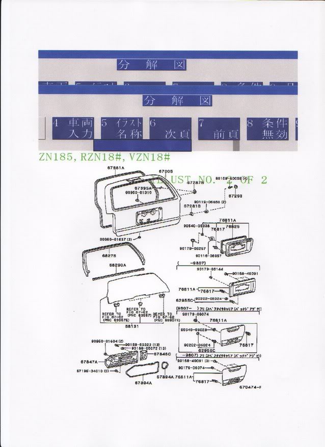

Here's some pics with Part Numbers for the factory tire carrier. These were posted somewhere else on this forum but I cant remember where.
There is alot of work to do to add these....
