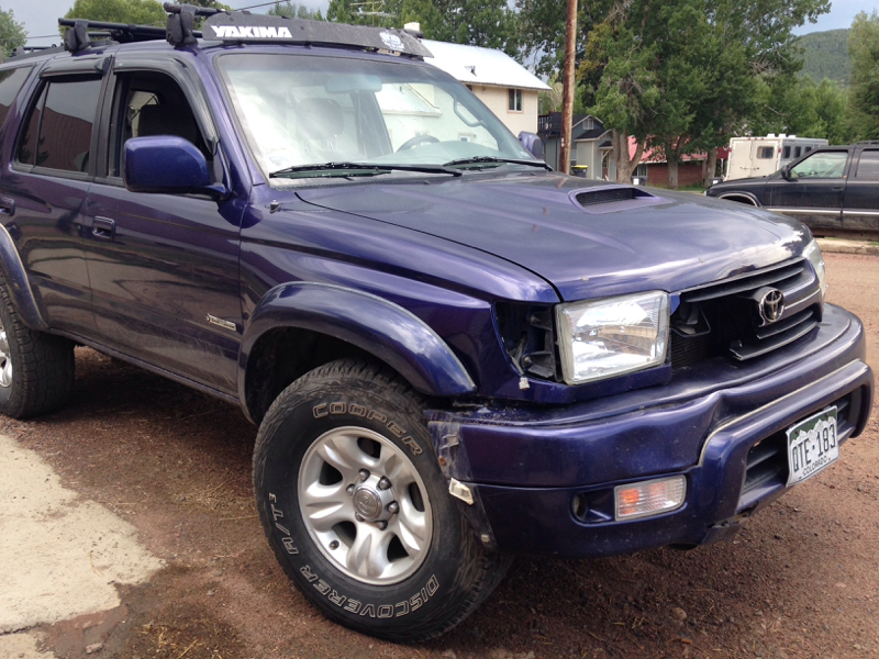

Thank you! I am completely new to this so in advance sorry for my questions that might seem as common sense. Here's what I've got to work with:

Both Jason and Terry have the right ideas, start with build threads and pick and choose what's right for you. It may seem overwhelming at first but the more you read the more it will all fit into place. Find threads of 3rd gens that do what you have in mind.
Love me a blue 4Runner, lots of potential there and keeping it daily driveable yet able to do moderate trails is not unreasonable at all. That's what I've built mine for and it's fit the bill very well, morphing every year as experience and needs progress. There's a bunch of 4Runners out there built in many different ways, a rich database of information to pull ideas and information from.
I have 285/75r16. Running them has required modification to the pinch weld with a big hammer, some trimming of the bumper valance, 1" wheel adapters and a 1" body lift with a Sonoran Steel 1.2.
