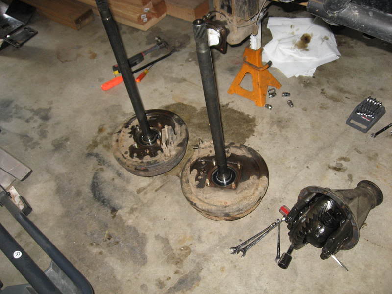

There was a dealership in Texas that recently was selling complete TRD Rear ends for $900 because they got an awesome deal on a pallet load of them.
There should not be a reason to replace your housing unless it it is bent.
Why not either have some one rebuild your third member or order a new one from some place like http://www.marlincrawler.com/htm/diff/pickup_diff.htm and replace the axles seals and bearings while it is apart.
I am a 10 thumbed mechanic and I got my rear end apart in about 30-45 minutes.
Undo the brake lines and emergency brake cables, 4 nuts on each end of the axle housing and 10 nuts on the rear third. Pull the axles out and than drop the third.

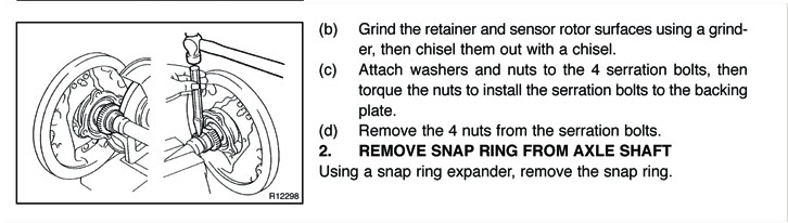

I'm not sure that I understand this part of the process???;
"Grind the retainer and sensor rotor surfaces using a grinder, then chisel them out" ...Will I have to purchase a new retainer and sensor rotor to replace the old one's that are ground and chiseled out?

all that is, it the bearings on the wheel sides are junk.
need new bearings, and new abs rings plus labor and juices/grease
A local auto salvage yard has a matching used rear axle assembly from a 97 4runner- 46,000 mi., available for $600
u will see the abs ring gear practically glued to the shaft. it has to come off. a new one will slide and press on, but the old one will not come off. you need to split it and pop it off, or cut a slot into it so it will release it's grip. that's why when you get new bearings you also get a new abs ring, cuz the old abs ring must have been destroyed to get it off
