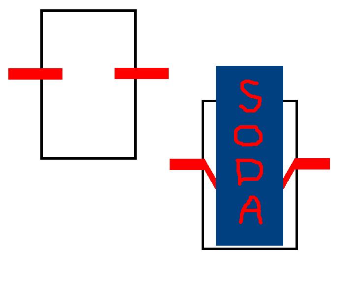

Might I suggest you try something a little different with the foam? It might be even more convenient this way...

Rocket; yeah, that's an idea... but I'd think that a box would look bulky in there. Ghetto wise... ummm, check this pic again:
There's something in that pic that's a lot more ghetto than a piece of unpainted PVC. (hint: look "up" from the flashlight)
Christian; okay... that could make me move it forward. hmmm...
Peter; hmmm... I'll have to give that a shot before I glue it down. Thanks!
I think Tacoma Dude's on the right track with this idea. I had to do something in my T100, because the holders are rather large. They'll hold a Big Gulp real snug, but a soda can, pop bottle or small McD's cup will wobble around and topple over if I take a corner too quick.
I used 3 short strips of foam tape, lined them from bottom to the top and spaced them around the holder. This has worked really well and I figured it would be easy to replace when they started to get chewed up, but so far it hasn't been a problem.
