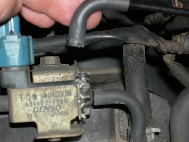

looks like the part needing to be replaced is Denso 184600-1960. Not sure what it is called? It has a plastic nipple coming off of it that the soft round tube slips over. it broke right at the base of the nipple. no chance in fixing that. does anyone if that is the toyota part number before i call?

If I had the slightest clue where it was, right now, I'd send you the one from my 3.4 swap. The 90* hoses and the hard line pipe are connected to your vapor pressure switch (by the firewall). Your system would work fine if you just remove the 90* hoses from both ends, and replace the whole works with a single length of vacuum hose.

Thanks. But if I had somewhere to connect the end of the hose at the evap end of that, i would. That would be the perfect solution. The nipple that comes off of that device circled in red is no longer there after i accidentaly broke it off trying to hook up the chain on my motive power bleeder, therefore I have no where to connect the hose. Does that make sense? In other words the nipple is stuck inside the 90 degree rubber tube and i am left with nowhere to connect a vaccum line.

That bad boy looks like its been glued before.....

yep appears there was some definite "glue-age" on that little sucker... ...i say just run to the local junkyard and try to find a 3.4 to nab the part off of...

Part number if anyone is interested is 25860-75140. Stealer wants $90. I am off to the salvage yard.
