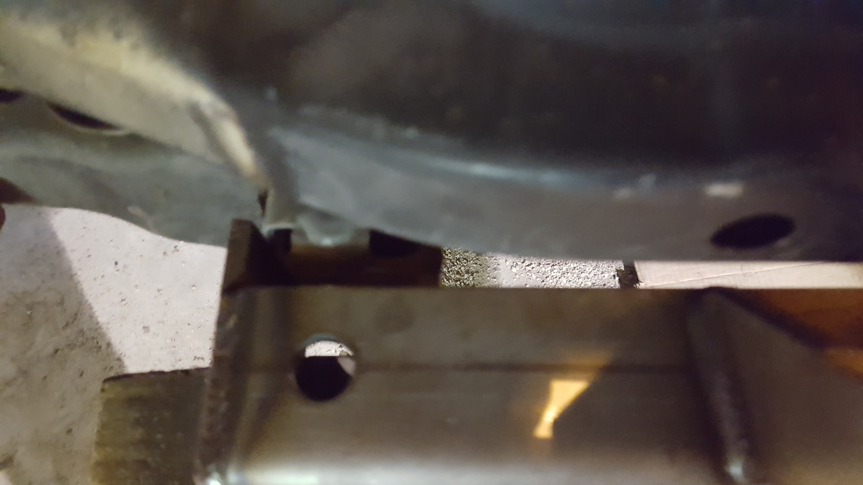

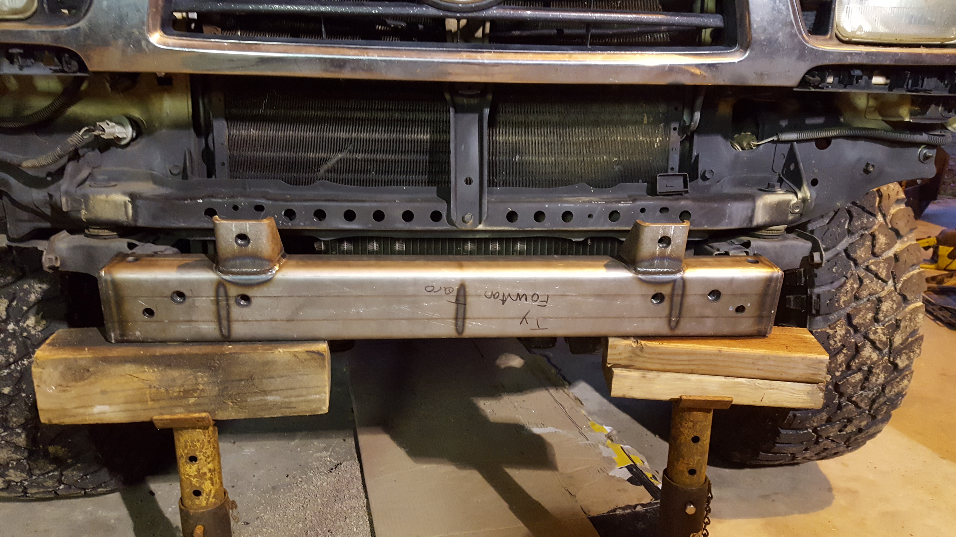

I bought a plate bumper from addicted off road for my dad a while back. I finally got it in and I can't figure out how this thing mounts. No instructions or anything came with it or on their site. It says minor cutting needed to fit. No biggie..but I can't even figure how this goes. I have emailed and had my wife send 2 messages on fb to them with no return calls or messages. We had this same problem when we ordered. I tried to call off and on many times and never got an answer. I figured since it was close to thanksgiving that maybe they were off for the holidays. I see now that they are just that hard to get in contact with.
haso anyone else ever dealt with them?
I'm going to try and includesign a few pics and maybe someone can see something I dont

As you can see, it looks like this piece is boxed and would fit the end of the frame. It doesn't though. It is about 3" off and as you can also see, the upright tabs are almost hitting the lower radiation support now. If it is pushed back it will be into that support. Where the bumper looks to go up to the frame, you would have to cut off a brace/bushing support part of the body to frame.

After a bit of digging I found this:
1) you need to trim off the side bumper supports. And, you will need to trim off the original frame cap on the front of the frame to allow the new crossmember to slide over the 2x3 frame. This all can be done easily with an angle grinder.
can someone point out the side bumper support to me..just to clarify I'm looking at the right part

I have called and called and called. Left 2 messages on fb, and an email. I called twice today and left two voice mails. I don't know what else I can do..and I don't know what to do with this bumper. I see where it looks like it boxes over the frame horns..I get that...but it's hitting whatever the thing is with the bushing on it that is right off the end of the frame about an inch back.

Here is what it's hitting and not allowing it to go back

The part your red arrow is pointed at is the side bumper support
You need to trim things to fit .
If you were close I would be glad to help.
If your uncomfortable trimming parts to get the bumper to fit return to stock.
Another option is to design and build your own front bumper support that will work as things are

Ok..getting a little further now. Is there any way you may can show me on that pic where I need to trim it at? Alps, how far back should the support bumper sit? Should it go all the way flush with the end of the frame or will there be a gap there?
I'm wanting it to sit as tight as possible to the truck
