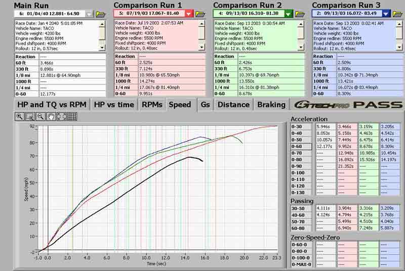

well guys i just want ot show you some stats that i colelcted form runnings
....in the pic you will see my gtech pro doing its work.....
the MAIN reading grey is stock (˟˟˟˟ting running stock)
THe last 2 on right is just tonight with supra maf and the red is without supra maf....you can see the gains the supra maf itself did....my truck is currently still need of tweaking as it garggles a bit at full throttle (hence the blue lower speed) but i did some more runs and it averaged out to a 16.1 quarter mile wiht 16.01 being my fastest.....i lost a whole second just to the supra maf....god thats crazy...and my truck still needs some more tuning as i got a minor air leak in one of my boost tubes that will need some working on =]
wow does the truck ever pull form 3.7krpm to redline gawd its like a turbo just kicked in anyway will fill yea in on my progress as well.

Wow... VERY nice times (and I'm liking the GTech as well!).
So, what's the difference between the grey and red? Is the red JUST the S/C or is that with the S/C and the injectors/fuel pump?

[B]the MAIN reading grey is stock (˟˟˟˟ting running stock)
Do you mean totally stock or just the S/C? Any other mods?
That would be first priority on my list if I had a bunch of leaks or at least one leak. I would also check the rest of your tubing for dry rotting, and replace them too.
Not really knowing what's going on in your upper RPM's and what you fuel zero is set at, I'm going to attach a map that may or may not fix your WOT throttle settings. Without seeing what your AFR and BR-3 is saying at WOT, I can't tell if garggle means lean or rich, so I'm going to assume your running a tad lean. So here's the map! Try it out if you want, and let us know what you find! I'm going to assume you run the A/C usually for the idle row changes, okay!
Also, notice the difference in RPM's on your analog map and mine. It needs to be like mine if you want your last two rows up top to do anything at all. Let me know how it runs in comparison, and we'll go from there. Make these changes while the truck is idling, and make sure while in the first row, only change one number at a time, and no great than a 1 number step in either direction, so you don't stall the truck out.

Well Chris my truck seems to run much better with the supra maf then with the stock one....i pushed the truck it its limits yesterday after abti a smooth dirving to get ecu to learn new settings....im ognna try those settings...but there is something much different between the first gen tacos and the 4runners all together....my truck reacts better with the less gas....i mean at lower rpm i have to start increasing numbers to keep it from throbbing (hesitating) as right when it goes into a higher band it starts to pull big time youc an feel the power hit a certin point and then boo yea im gone =]
The grey means stock.....with only fipk....the truck wasn;t running right but im jsut compairing my stock vs my truck now so most likly that your guys's trucks are a bit faster stock then mine was at time. (some sensors ahd to be replaced spark plugs were crappy)
My fuel zero is at 0
But again my truck runs better and faster in higher rpm in all gears....so im thinking its the lower rpm i gotta work on.
ANyway ill try your settings tonight as well!
