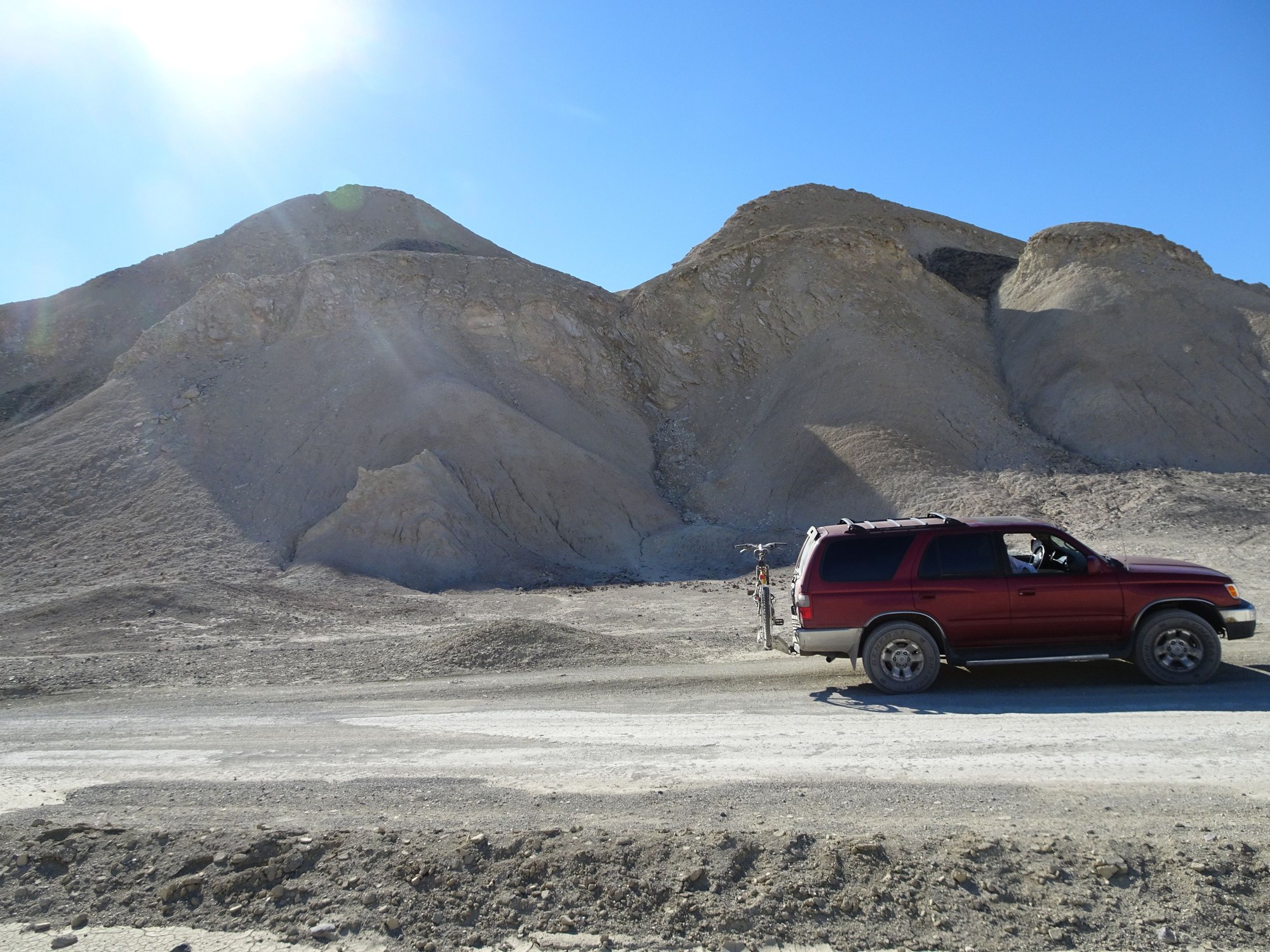

From the outside it doesn't look any different making it super stealth

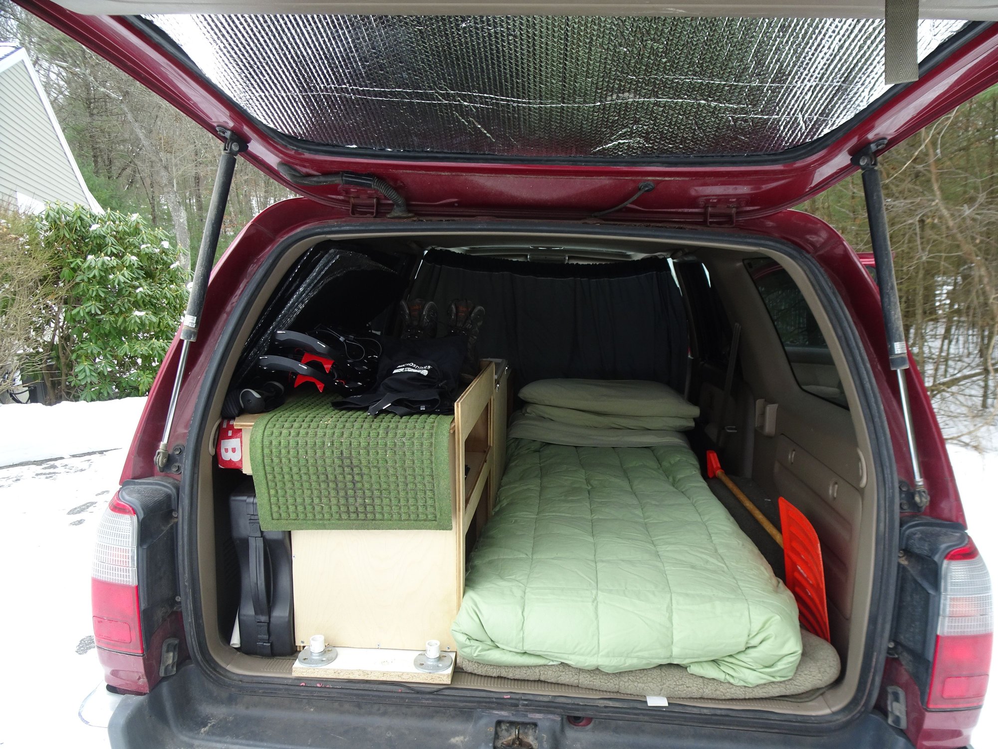

the back is divided in half with the bed on the passenger side and the built ins on the drivers side

Here in winter time you can see the insulated shades on the rear window. They are reflective on one side and covered with black felt on the other. Also here I have the bed made with the down comforter and flannel sheets.
The front is not really any different except the use of the passenger floor for shoe storage and my day pack in the passenger seat.
With the rear seat bottoms take out and a bridge I made to cover the gap between the rear and front seat I have about 6 1/2 feet to stretch out.
