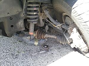

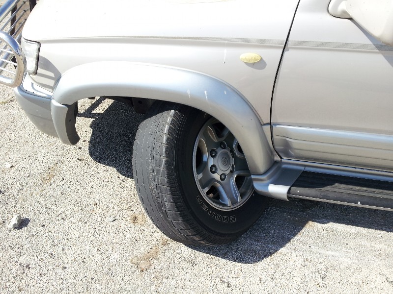

I used moog, less then 10k miles later:

Jeez. Somewhere along the line I came to associate Sankei with OEM (at least in terms of BJs).
Sucks. I really only have tomorrow to wrap up my front end work so I'll have to use the 555's, but I'll swap them out asap.
Tex, did yours fail because the stud snapped off, or is that a side-effect of bolts shearing, or some other event?

No, like most aftermarket failures the ball simply pulled through the socket.
