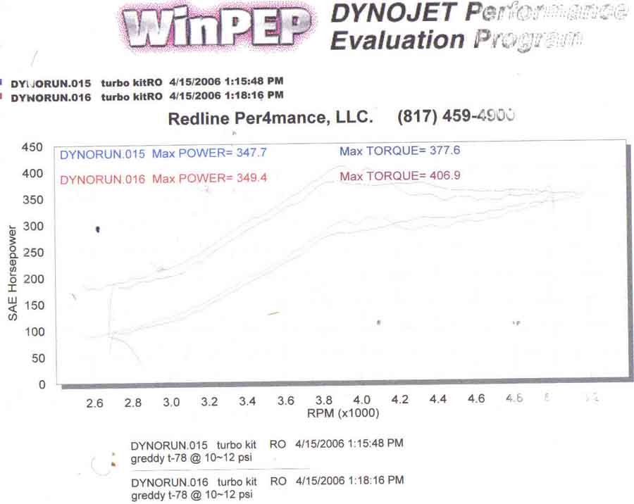

Here is a dyno sheet from a turbo'ed 3.4L from over on custom tacos. Pretty good numbers!!!
Who is that?
WOW!!!!! I would hate to be going that fast in a truck.

Originally Posted by WATRD
Who is that?
His handle on CustomTacos is bputacoma (i think). It's a 2wd little sport truck yota.
Otherwise, 300RWhp has always been a sort of holy grail for 3.4 tuners...
{knock knock knocking on my door...}
Dave's hit it (as has been said)... I'm getting close.
But like Gregg showed, that line's been easily broken with a turbo setup. Boost is cool as long as you can keep things together.
Who is that?
817 is Fort Worth if that helps.

Originally Posted by AK95Taco
There is always the twin turbo that URD and F2uning built Here
Something like 800hp!!
Yeah... Brian Trager (Gadget's west coast guy) is driving that, but that's a bit past the "over-the-counter" bolt-on stuff. Though the new turbo work that's happening here in Seattle is gonna be pushing 350hp at the wheels or more, and will be sold as a bolt on.
YT member Greedy (Gregg) is the donor truck. He's running and will be on a dyno next week if not yet this week. His thread's here.
This engine LOVES boost - it responds very well to big boost numbers as long as you can keep fuel in it. Gregg's engine is stock outside of the turbo (i.e., no camshaft, crank, piston or valve work). The mods are larger injectors, an FTC1E tuning module and the Walbro. I don't even think he's running headers.
