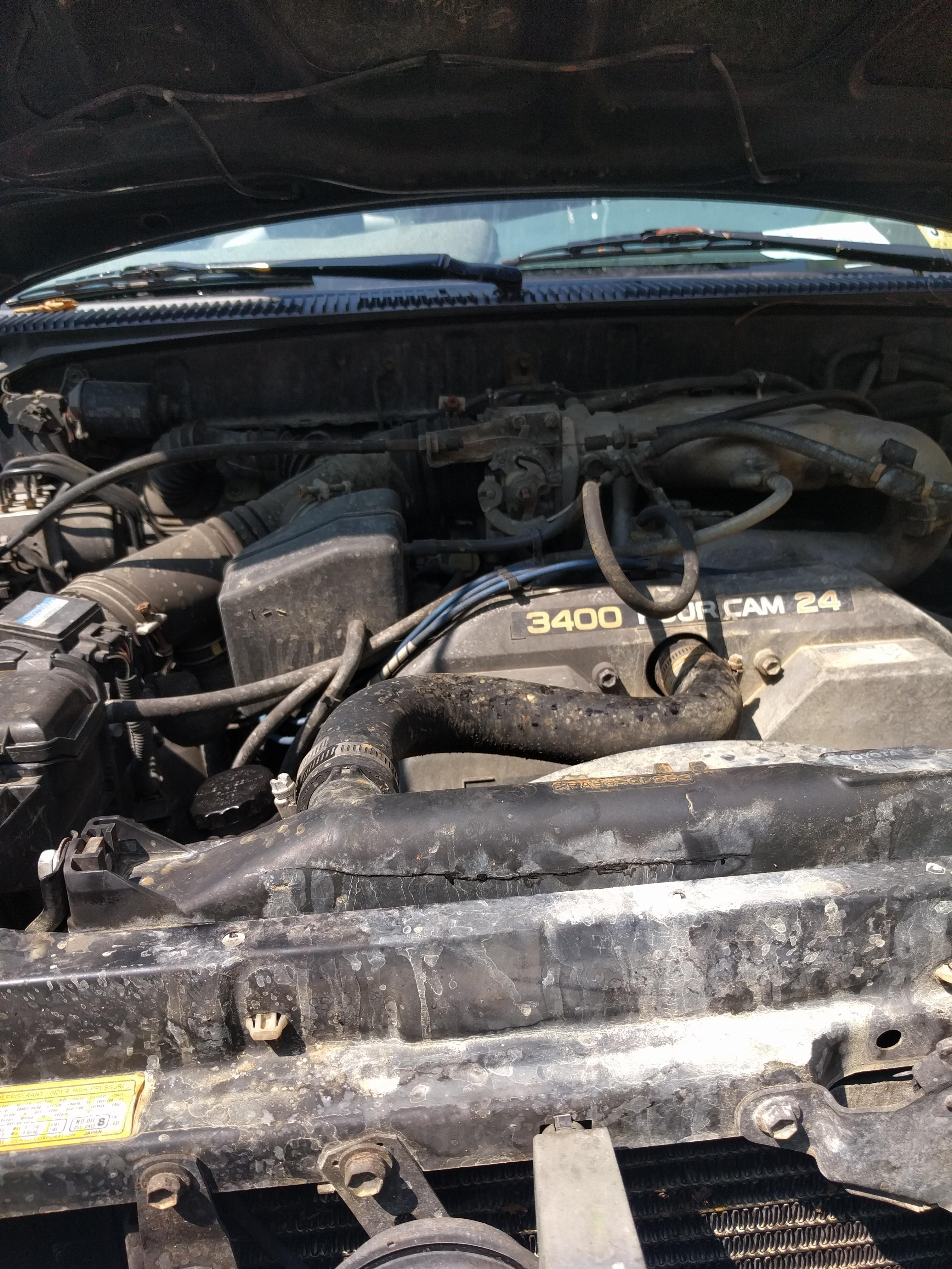

The second pic is the engine oil. I was going to put up the hot and cold pics, but this is the engine warmed up and you can see the oil is right between where is should be when cold.

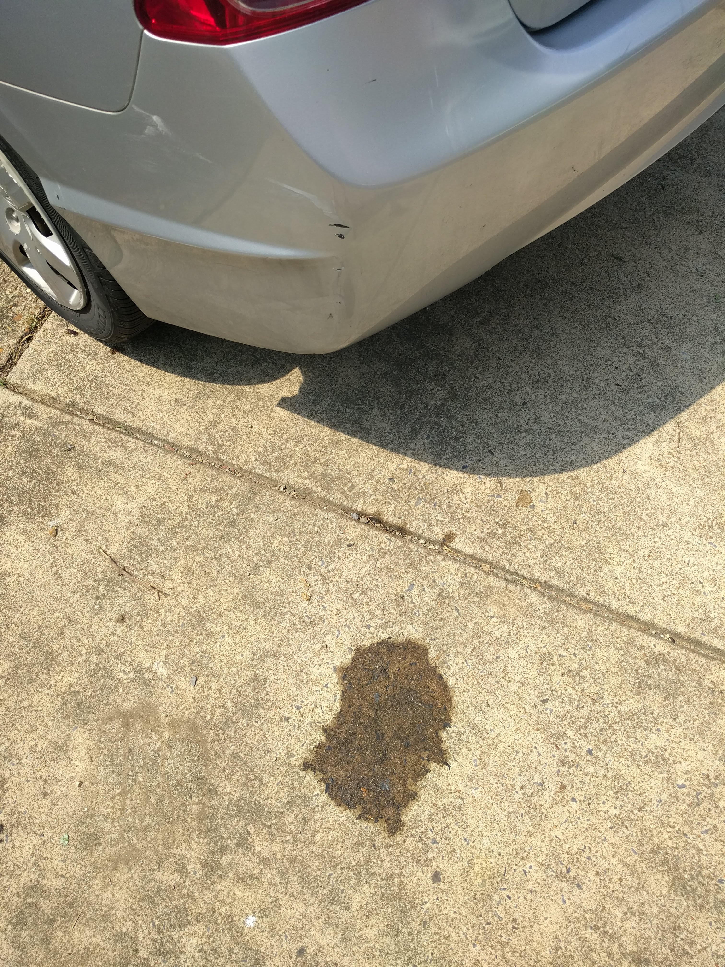

The third pic is the spot where the red tinged fluid had leaked out a few days ago, I didn't know if that could be useful for how much had leaked out.
