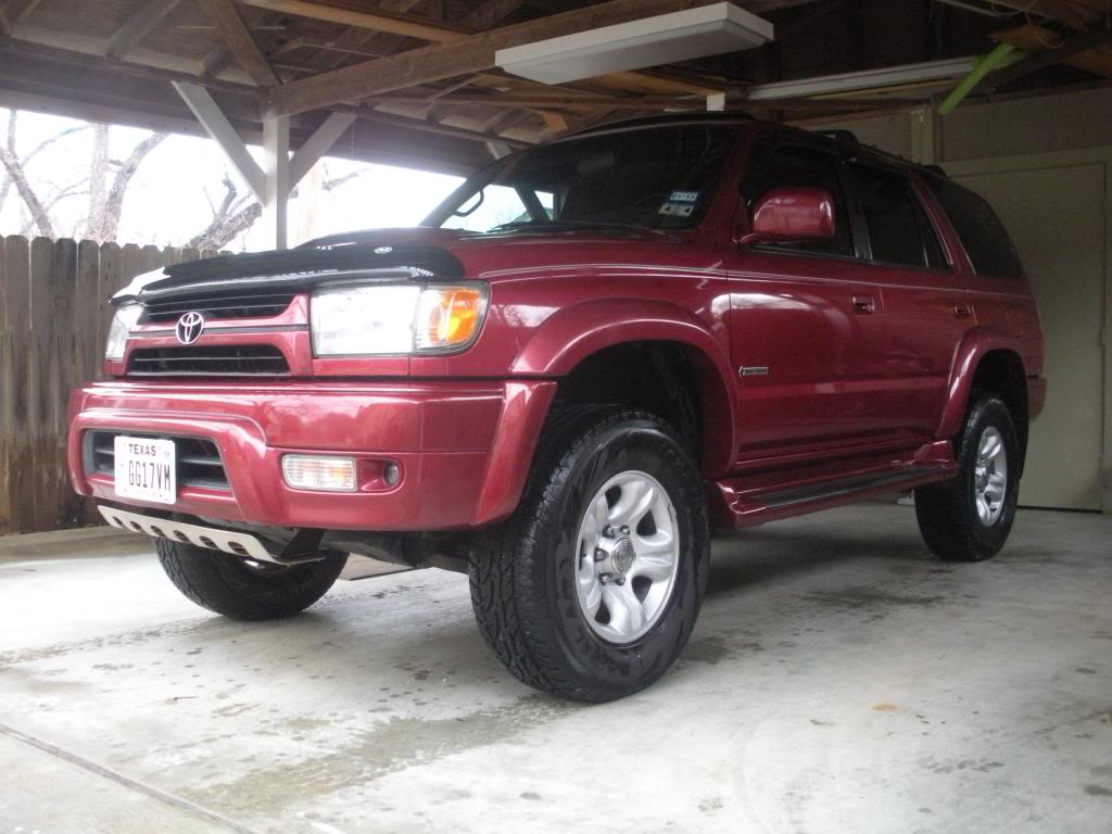

I got the Eaton tru trac installed along with daystar 2.5 spacer and it climbs slippery hill's so much better and, is the height it should've been from the factory. I'll get some pics up tomorrow after a wash. I appreciate the advise.
