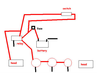

my aux lights are wired on their own circuit with a fuse and relay... anywyas... i want to make them also lighted by my highbeam switch... what wire do i tap and i jsut connect that into my other signal wire to the relay right?

well i jsut sent an email to roger brown... he responded.. said it was most likely red/green... and since anotehr member here said that also... i tried it.. it worked..... now i get my brights to come on and my aux lights... and my aux lights are still wired to come on manually eiht an in cab switch

here is the way my ligths are set up... they run with either the switch in the cab, or whenever the highbeams are turned on
