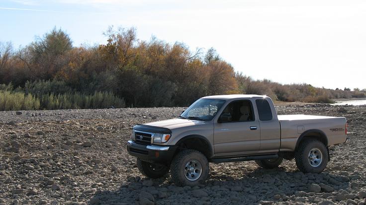

Sorry, I thought I had a sig. I have a 2000 TRD Prerunner V6, I have allpro off-road 8 pack leaf springs. It's stance is good, but when I load it up it sags.
