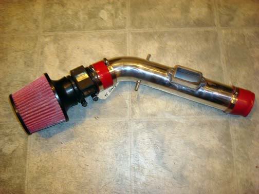

I assembled the cold air intake that I was referring to in the beginning of the thread. Here is a couple of pics for you. I assembled this using the 98 MAF I also acquired as a standby replacement. the way it has been discribed here I felt it would be a good idea to have a spare when I could pick it up for $25.

I have another question for those who have done the cold air intakes, if you look at the complete unit, this pipe has a flange on it but I can not figure out what the heck its for? I do not see anything in the engine compartment that would fit up to this opening. Do I make a flange cover and screw it in place using a gasket? I have no idea why its there or what is supposed to be for

That's not really a "cold air intake" since it will induce hot air from the engine compartment.... Just a marketing tool to sell 'em.
That pipe doesn't look like it's for a 4Runner??
Well it is and the box says "96-98 Toyota 4Runner" and the picture is the exact same on the box as it is as I have shown. yeah I was wondering about the port on top but it does say its for a 4runner. I did set it in the engine bay and it doesn't seem like it will fit properly, just have to take a weekend to try to see if I can get it to mount up.
