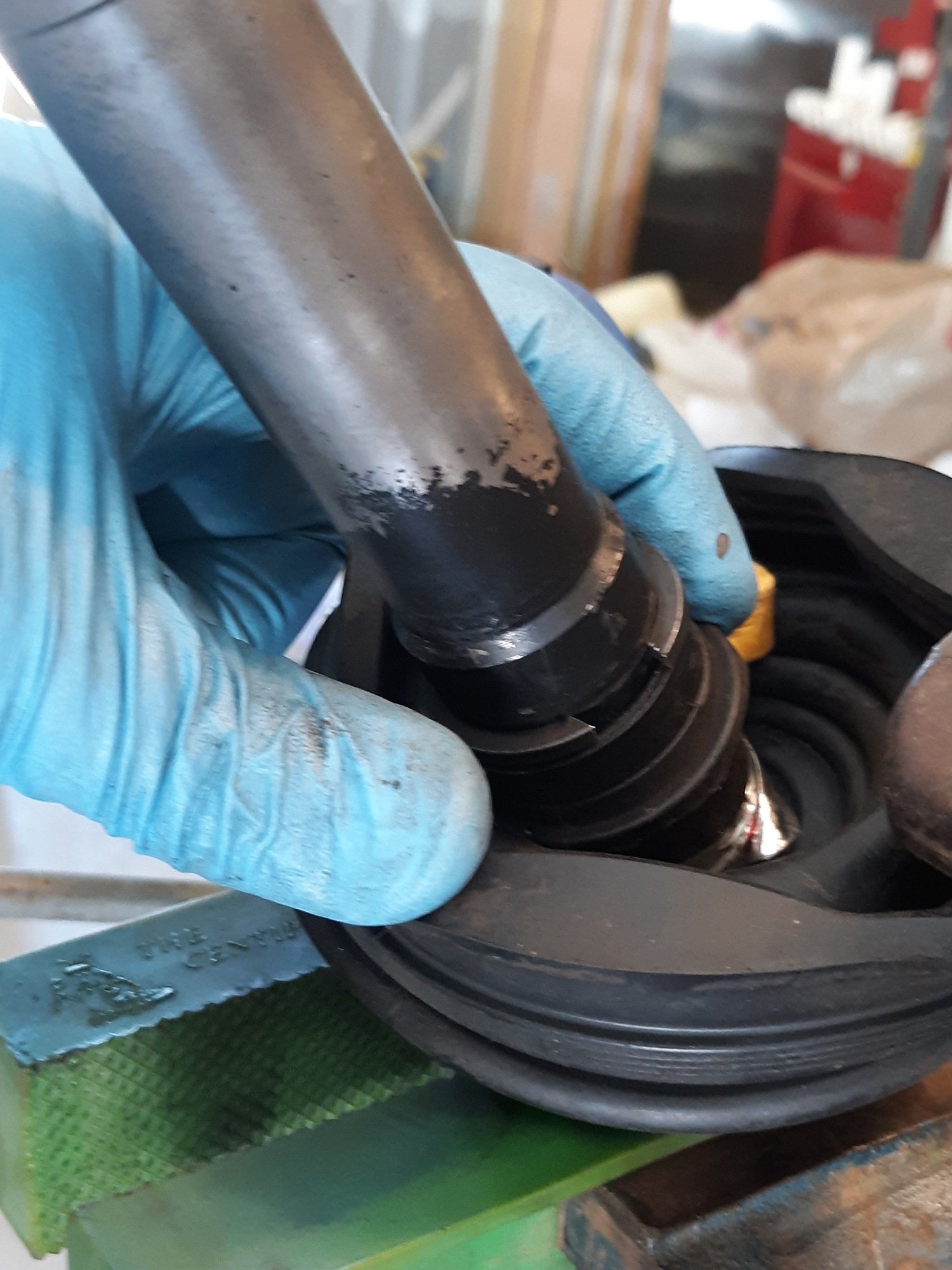

cut old boot off but retain the outer, small end of the boot. the rubber ring will be reused as the spacer for the mod
remove old grease

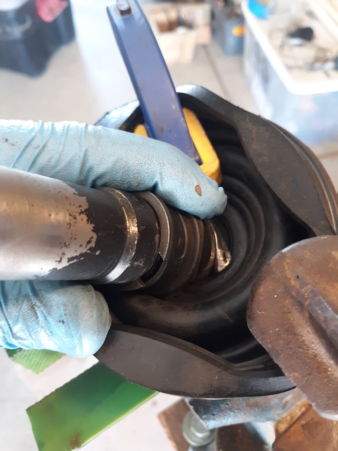

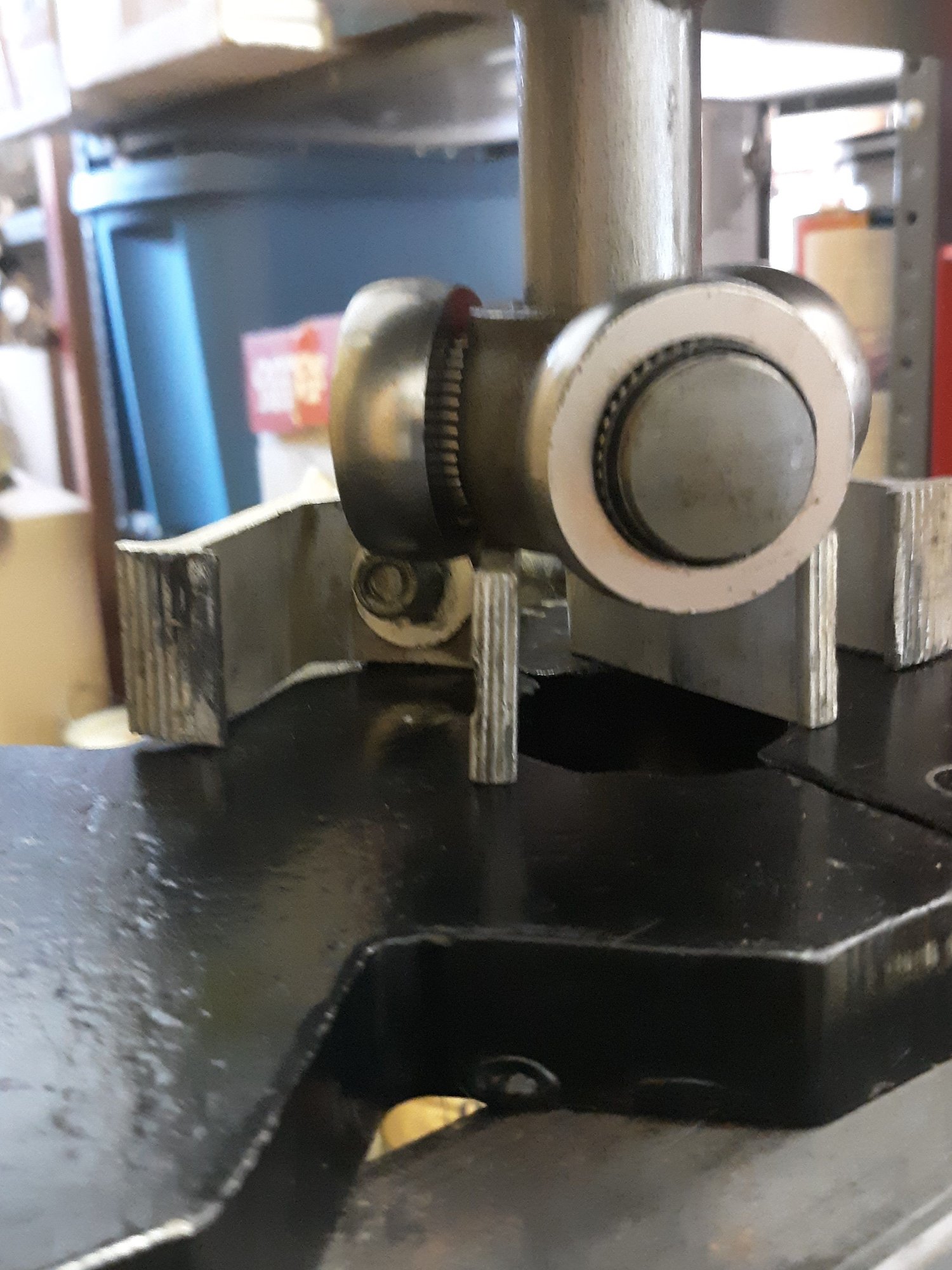

remove snap rings on the tri-pod bearing then slide off the spine. You can drift these, I used a press. some models , like this one, have 2 snap rings. 1 on each side of the tri-pod.
remove the remaining boot ring and clean the axle, trim ring to a 1 - 2 in wide ring (mine was an inch and the new boot ribs still rub, so I am going to redo with a 1.5 to 2 inches of spacing).
install new boot, spacer, snap ring below the bevel on the axle

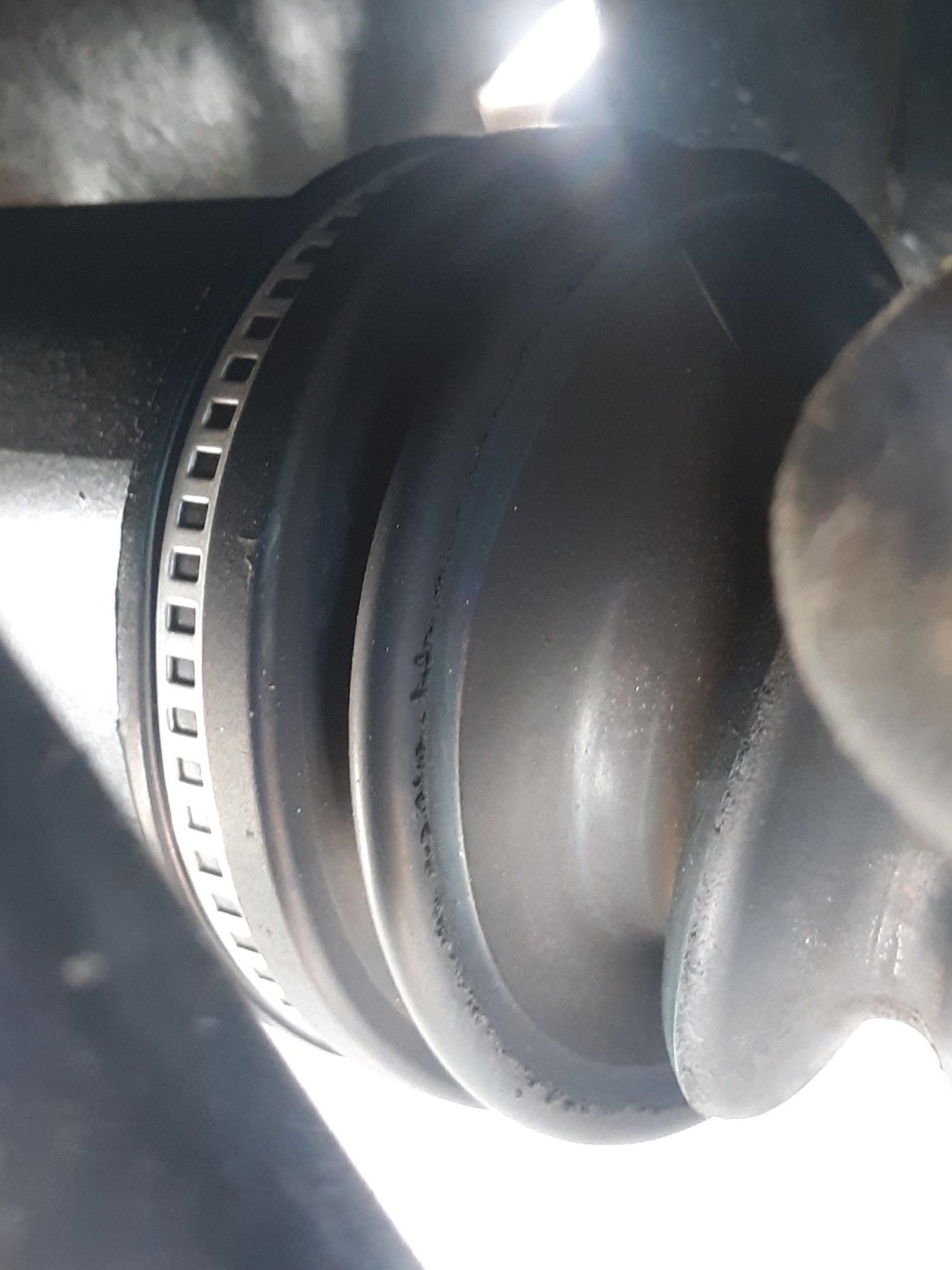

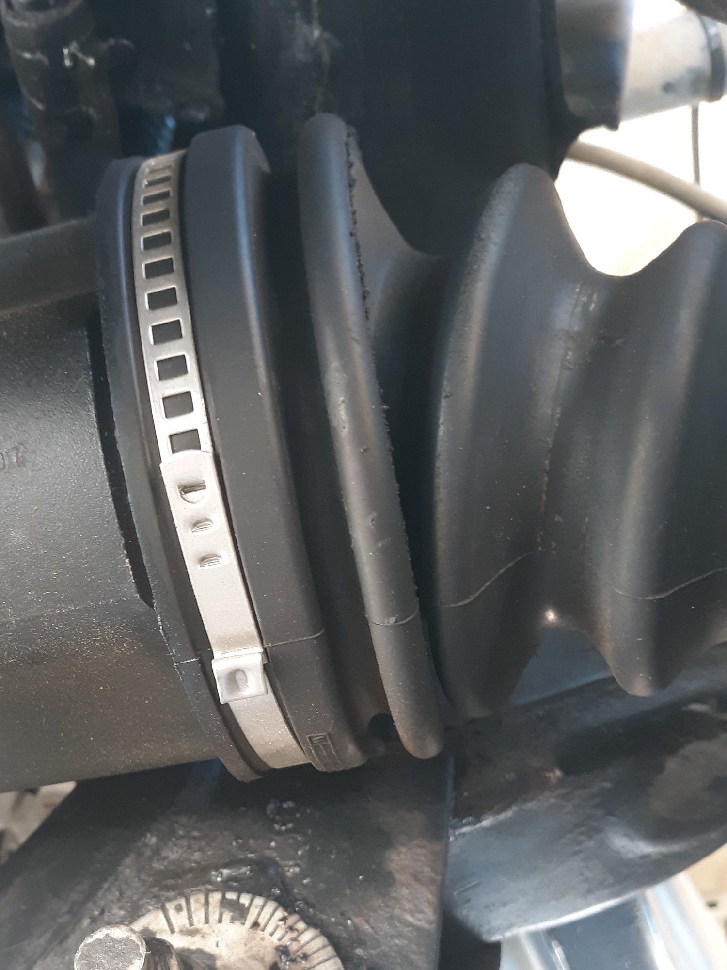

here you see mod; in order the axle bevel, the snap ring, modified boot spacer and the new boot
shows the wear groove, last rib of the inner boot still with the mod spacer

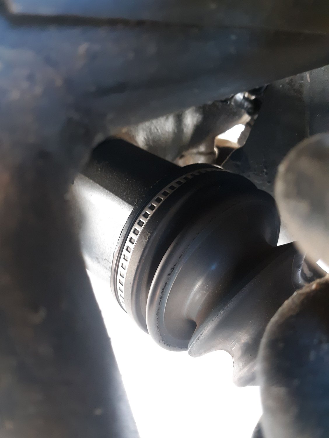

position of inner boot ribs on flat ground with the 1" mod spacer. Can see only 1 or 2 mm space.
shows the wear groove, last rib of the inner boot still with the 1" mod spacer after about 400 miles
bevel, snap ring, spacer, new boot
tri-pod bearing after pressing the axle out
