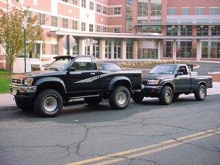

Ok,... here is a picture of our trucks. Look how much height he has on me!!! How many inches you think?

Thanks alot! I have done some reading and so far i learned some but I have much more reading to go,... I want a good lift so that I can stuff 32- 33" tires without having to worry about my CV's going bad early. My friends truck,... do you think he had a 6" lift? I know he has a 3" body lift. Thanks again. I might go for the 32's seeing that I dont plan on rock crawling or anything like that,... if anything trail riding,... kinda like rally racing conditions. The 32's are a bit lighter so that means i'll be a bit faster. A BIT. Thanks.
