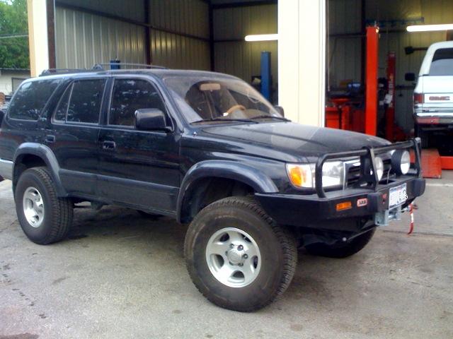

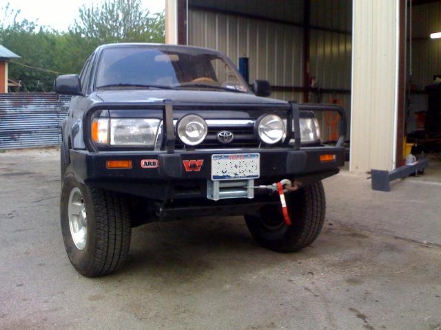

I finally leveled out my front end....(pic)
Ome 881s front 890s rear. The winch was too much for those 881s. So I added the daystar 1.25" topspacer and SS dif drop. Now it sits 1/4" high in the front. I think adding the spacer is a great way to level out the ome lift, but only if you have a bull bar and a winch. There is No rubbage at all. By the way the michellin all terrains do great in the sand.
Attached Thumbnails I finally leveled out my front end....(pic)-photo.jpg   I finally leveled out my front end....(pic)-photo-2-.jpg

Looks good man, you've got a badass lookin 4Runner!

Looks great. I love the LC rims.
I think you should paint your rear bumper to match the front. All black would look great!

Man, that looks really good. You got it going in the right direction now.

looks good. now ya got to get rid of that chrome rear bumper.

stupid question but it looks kinda blue, is it black or blue ?

It's black. Traben, didn't anyone tell you? The mexican food is waay better when you're closer to the border...and labor is cheaper.....

So when are you going to get some more aggressive tires? The road tires just dont match the tough bullbar/winch and lift look...

i have a set of procomp muds in the garage, I had them on for almost a year. They were very annoying, never stayed balanced, and made my 4runner drift to the right badly. I figured if I get stuck with these tires, I have a winch. Plus these tires are better for sand than mud terrains. They wont dig in as fast. Also, You know how some people have hilifts mounted? I'd like to mount a danforth boat anchor somewhere. When you get stuck at the beach, there's no trees to strap to. So just run the winch line out, shove the anchor in the sand and tug.
