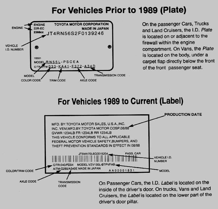

which FSM do i look at for my trans? i am not sure. i have the 5speed v6. i have that FSM but it has NOTHING about manual trans

look at the manufacture tag under your hood. it will have the trans type on the tag.

here is the key for that plate...
Attached Thumbnails how do i adjust the master/slave cylinders on my 2000 4runner 5speed?-toyotavin.gif
