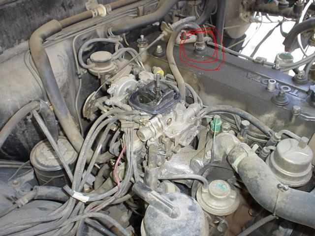

Everyday i notice something else about this truck that needs to be fixed or replaced.. Ok.. new problem now.. I was looking around the engine yesterday and spied something in the back behind the air filter that looked wierd. I have a 22R engine for people that don't know (but everyone should as many problems as i have been having). There is a hose on the back top part of the engine. It runs right into the header and there is electrical tape holding this hose into the engine. It seems there was a plastic connector peice there and it was broken at one time or another so the people applied so kind of glue which really is not holding it that well and wrapped it in electrical tape. What is this hose for? It is the only one of the top back part of the 22R engine. What does it do? If i need to I will take a picture and post that. I would like to know what this hose does and what the plastic connector peice that was broken was so i can again.... have something else on this truck fixed...

I've got a 22R here myself. If you do mean the hose is running into the headers, and not the head, then I wouldn't think a piece of plastic would last long against hot exhaust temperatures.

The only thing I can think of is the PCV valve hose??? That runs from the base of the carb up to the valve cover. I don't recall ever seeing a hose to the header.... But I think I have some digi pics under the hood of my truck, let me browese, and then maybe you can compare... just a minute!
Anything look familiar to you? The air cleaner is off, but there are only three tubes coming off of it. One is a tiny one (hanging in the pic with some tape around it towards the left of the pic. Another goes down into the plastic chamber at the bottom of the pic, and the third runs from the front of the aircleaner assembly down to the silver opening on the valve cover, right above the y.

Sorry for not being very descriptive earlier.. Thanks for all the replies guys.. I have circled the hose in the pic. Like i said.. the connector is just glued back together.. and not glued very well.. still wiggling etc.. and then just electrical tape around it and the bottom of the hose... Not very nice looking and it worries me a little when i look at it.. What is this hose? How much you think to replace it and the connector? If i can order the parts i can prolly do it myself.
That is your PCV valve hose. Definately go and replace the PCV (the plastic connector; its actually a valve that allows the crankcase to vent air, because as air heats up it expands and it needs somewhere to go). It should only be $3-4. Hopefully the grommet is still good. I couldn't get mine off, it was too heat soaked, it would just break.
The plastic piece should come out and then there will be a rubber grommet still in there. That might be baked to a plastic consistency though. Atleast replace the PCV valve, if it goes into the grommet and it isn't a tight fit, you will need to replace the grommet as well. Just be careful not to get any pieces in the valve cover.

Gotcha.. Think Napa or another auto parts store will have it? Will i have to remove the header or will it just pull out? That is the header right? or is it the valve cover.. i have so much to learn. Thanks for all the help so far.. I feel like with all this truck needs i could have bought a new one
Its the valve cover. The header is right below your spark plugs, beneath the heat shield. They are the exhaust tubes coming from the engine block.
Napa, checkers, all of them should have it... Though it took checkers 4 visits for them to re-order it for me. Buy both the valve and the grommet(to be on the safe side). All you have to do is pull the tube off of the old one. Pull the old one out, might have to wiggle it out (and hopefully they didn't glue it to the grommet), then insert the new one. If you don't know which way to put it in, press is to your lips and blow out it with your hand on the other side. You should feel air hitting your hand one way and when its facing the opposite direction, it shouldn't let any air pass. When it does allow air to pass, the side you have your lips on goes onto the valve cover. This is so that the crankcase can expand air out, but it won't suck any in. If it doesn't fit snuggly in there, then you will need a new grommet as well. That's trickier, and I didn't do it myself. Then hook up the hose and you're set.

The PCV hose is supposed to be held on with a metal pinch clamp. Somone probably lost it so they did the glue/tape thing. I'd just use a 15 cent hardware store clamp if I were you, or get one next time I go plundering the junkyards.

Now that I think about it more, get a mechanic with some practice on Toy trucks to do a full tuneup. They will adjust your valves and get your timing just right. While they have the valve cover off its a good time to do the PCV valve and gromet so you don't have to worry about gromet pieces getting in your valve train.
