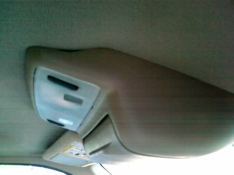

Non-sunroof field monitor mounting bracket?
Originally Posted by Rock Slide
Unlike Midiwall?s 4Runner, the blue sunroof plug in my truck was completely different in size and pins compared to the new Field Monitor. I also did not have to swap my mirror out or cut my headliner to make the new field monitor fit properly. And just to point out, since I have a factory sunroof in my 4Runner, I did not need the metal bracket like the non-sunroof version requires.
Hey Rock Slide, thanks for such awesome and comprehensive coverage of this mod—it's really well documented throughout the many different forums b/c of your writeup. I'm looking forward to doing the install in my '97 SR5 having just acquired the JDM field unit on eBay (shipping to me from Japan). After many search queries on Google and on these forums, I still have a leftover question—what is the required mounting bracket for installing a field monitor in a truck that doesn't have a sunroof? My SR5 doesn't have one and it sounds like I'm going to need to figure out what the bracket is, and try and get my hands on one so that I can secure the unit to my headliner.
I'm just curious if you or anyone else have seen this install done on a non-sunroof T4R and could help me out with a P/N or some install pictures or something.
It's not a bracket itself being the issue, it's the fitment of the plastic trim piece holding the unit that needs to be a non-sunroof FMU. Without that, it will not fit correctly in the headliner of a non-sunroof 4Runner.
For example, referring back to my 1st post, notice how this sunroof model FMU is cut to fit my headliner without any gaps. My 4Runner came stock with a sunroof. The oem compartment I removed to swap in this FMU, was cut the same way as this FMU:
Now a FMU that came from non-sunroof model Surf would look more like this one below (the one below is not a FMU, but the plastic surround piece is identical). Notice the difference in mine above and this one below. The one below has an oddly cut lip at the end near the map lights that mine doesn't have. Plus mine has a bend right in the middle that the one below does not have:
(NOTE: The 4Runner pictured above, had an aftermarket sunroof installed, thus causing the factory compartment to no longer fit the headliner afterwards as the gap that can be seen near the map lights. Had an aftermarket sunroof not been installed, the above compartment would fit the headliner correctly w/o any gaps in a non-sunroof 4Runner.)
In conclusion, you really need a FMU that came from a Surf without a sunroof in order for it to fit correctly in a 4Runner that came without a sunroof. At the very least, you need the plastic trim piece more than anything from a non-sunroof Surf. It would make your install a lot easier.

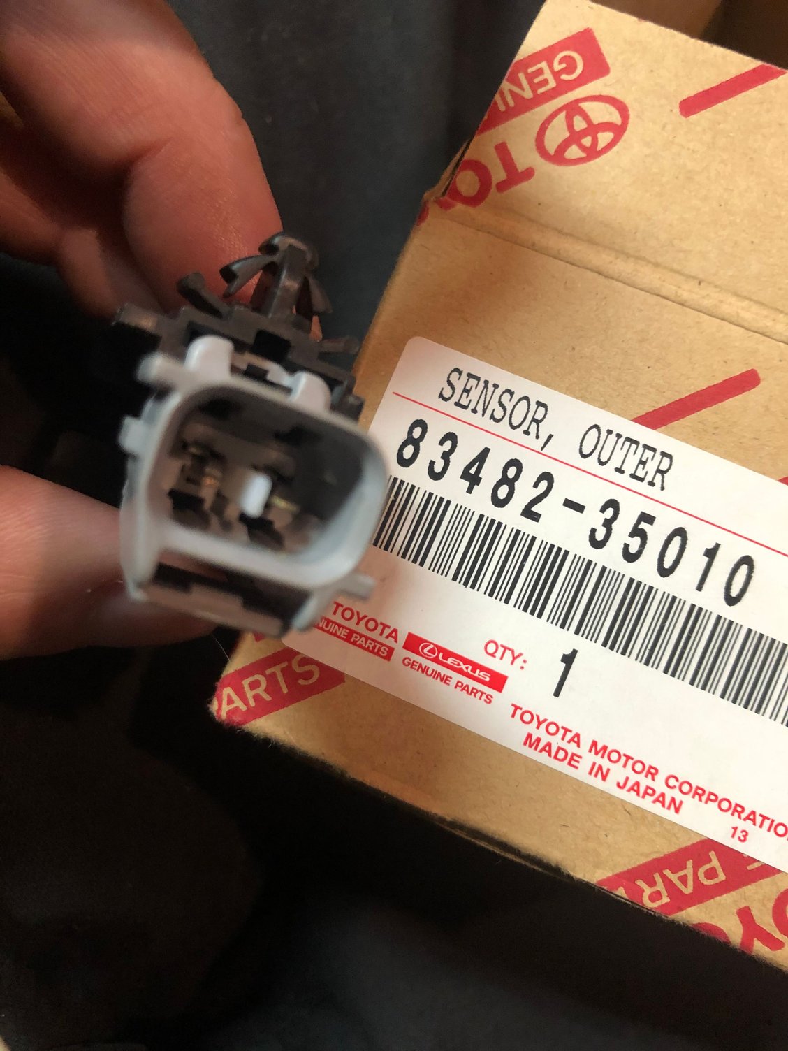

Going to resurrect this excellent thread because I added an FMU to my '97 today. Pretty easy install, all things considered.
One issue is that the temperature reading is incorrect. I couldn't source the original JDM ambient air temp sensor so I sourced a regular 4Runner air temp sensor from a wrecked 2000 4Runner. Without delving too deeply, these should basically be the same, right? A basic thermocouple.
I'm not sure if I have a bad sensor, or if the FMU requires a proprietary sensor.
Thoughts?
Old Feb 7, 2022 | 09:44 AM
  #89
Malcolm99's Avatar
Joined: Dec 2015
Posts: 713
Likes: 72
From: Ontario, Canada
it is proprietary, I have a new one in a box in Canada, My FMU didn't have Temp display because it has the temp in the Digital climate control unit.
Old Feb 8, 2022 | 04:57 PM
  #90
Theironyuppy's Avatar
Joined: Dec 2021
Posts: 15
Good info, thanks! Sent you a PM.
Old Feb 8, 2022 | 09:09 PM
  #91
Malcolm99's Avatar
Joined: Dec 2015
Posts: 713
Likes: 72
FMU ambient temperature sensor for future reference.
