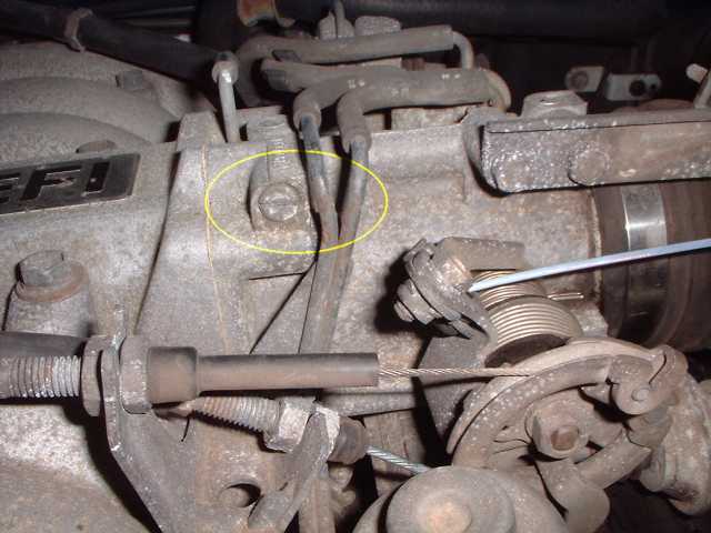

However, I could not find the idle air screw you are talking about. I took some pictures and they are here. Can you please let me know which one to adjust. Also, roughly, how many full screw turns are needed per 100rpm?

Not familiar with the 3VZE engine/throttle body. On the 22RE it is right on top of the TB. A Factory Service Manual for the engine should have the setting procedure.

Originally Posted by vkrunner
...I could not find the idle air screw you are talking about. I took some pictures and they are here. Can you please let me know which one to adjust...
I had the same problem after my ISR mod and TB cleaning. So I adjusted the idle.
I think it's the screw in your second pic: https://www.yotatech.com/attachment....achmentid=6904
Geneius, (nice nickname)
How shall I adjust that screw? Like rotate clockwise to increase or decrease the idle? Also any correlation between screwturns and ide rpm - meaning how many full turns are required for say 100rpm chage?
BTW, I DID adjust that screw - I turned about 60 degrees clockwise but that doesn't seem to effect the idle. I am afraid to adjust more so I returned the crew position back to original (as seen in pic).
I think it's the screw in your second pic: https://www.yotatech.com/attachment....tachmentid=6904
That is the correct screw.
Just turn it with the motor running. You should reset the ECU ( again ) after you get it where u want it.
