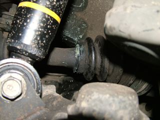

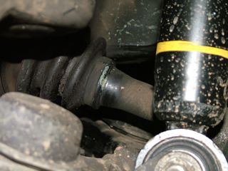

Now that I've installed the lift, it looks as though both of my inner CV boots are leaking a little. The boots are not visibly damaged (no tears, holes, etc), however it looks as though a little bit of the thick white grease is escaping from one end. I wiped all the grease off last night from the CV boot and surrounding areas where it splattered; got under the rig again today and saw the same white grease. See the photos below. There is just a slight amount of play in the CV boot - it will rotate a tiny bit around the shaft, but will not actually move up or down the shaft. The grease looks to be coming from the crack between the boot and the shaft.
So... should I be concerned? Does this type of leak warrant installing new inner CV boots, or is there an easy fix. What do you guys think?

my right (as of before my offroad trip) was starting to spew under the clamp.
im going to get new clamps and put them on, search around here there are quite a few incidences of this happening.

I had the same thing happen to mine when I lifted it. I just got two cv boot kits from toyota and put them on. They were around $40 bucks each. Granted I had 175,000 miles on the old boots.

The boots are old and have alot of miles on them. They got "used to" being in one sweet spot and that changed.
You have two choices.
1. Cut off the stock clamp and use a hose clamp. DO NOT put the hose clamp over the stock clamp, the stock clamp will then cut the boots.
2. Get a new set of boots and clamps. It's really not that hard of a job to change the boots, but it is messy and you need a snap ring pliers. Like "Snap On SRP2". One boot will have two fold overs and one will have a Tacoma style crimp, so you would need the crimp tool as well.

Happened to me too. As long as not too much CV grease has seeped out, you can just re-clamp it with a hose clamp (what I did). From the looks of it, it seems like re-clamping it is your best option...

mine did the same after my lift, its what Steve said. I just wennt to a Firestone and they replaced the clamp for around $10-$15. no leaks since

I'm not sure how much grease is in there but my 4Runner did the same thing and a couple of hose clamps made it right.

If you just have grease leaking from the clamp area.......Cut the clamps off, pull the boots back, remove as much of the old grease as possbile, add fresh CV grease (usually comes in packs available at the dealer), clean off the boot sealing surfaces (axle shaft and CV body), reinstall the boot and install new clamps (requires a special tool for crimping the clamps). They shouldn't leak after that.
It is a very different story if the boots were damaged/torn since often water, sand and other debris can wreak havoc on the bearings even after being replenished with fresh grease and a new boot. In that case it is a hit or miss as to how long they will last thereafter.

Thanks everyone. The leak is very minor, so I'm going to try the hose clamp route. Sounds quicker and less expensive than installing new CV boots.
