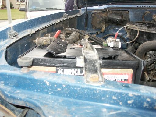

here are the pictures of my battery and a few of my truck i took also...enjoy
if anyone can take a look at there altenator and tell me which wires go to which posts it would be greatly appreciated...i obviosly hooked it up wrong

battery pic
Attached Thumbnails HELP, my battery just exploded, altenator problem..???-battery-1.jpg

another battery pic
Attached Thumbnails HELP, my battery just exploded, altenator problem..???-battery-2.jpg

yet another pic
Attached Thumbnails HELP, my battery just exploded, altenator problem..???-battery-3.jpg

the final pic
Attached Thumbnails HELP, my battery just exploded, altenator problem..???-battery-4.jpg

i did drive it home that night and today i was driving around town with a split battery, in the pics it shows the sides are all split half way down the battery
