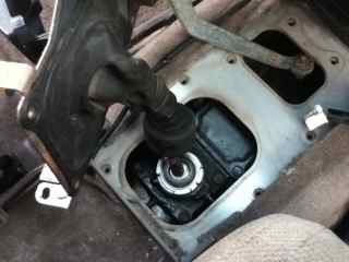

I noticed that my transfer case was almost coated with gear lube and traced the leak to the top as well. I couldn't find any photos of the remedy described above so maybe someone will find them helpful. The metal wafer was sandwiched between two paper gaskets that had been compromised needless to say. I also noted that a breather tube had come off . . . or was left off when I had to have a new tranny installed last year. BTW, 99 4runner.
Attached Thumbnails Help! Looks like tranfer leak-img_0115_small.jpg   Help! Looks like tranfer leak-img_0119.jpg   Help! Looks like tranfer leak-img_0121.jpg
