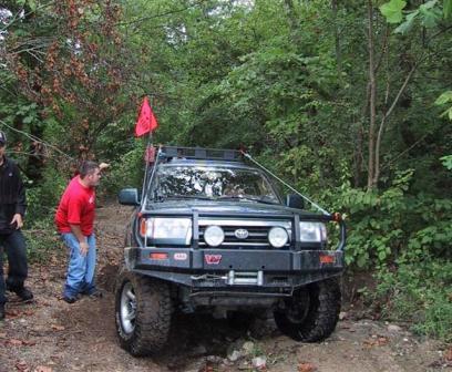

UPDATE:
Evidently I had the wire clamps on backwards...so if you are working on it, do the opposite in those pictures.
Been to work and back for a total of 1.5 hours driving. While the wires do jiggle a good bit, they dont come close to my hood or roof. Remeber I have a 2inch body lift, so my bumper is 2 inches lower than most. So if your bump is in "stock" location, you'll have even more room for jiggling.
I brought that up mainly because if I do hit a fairly large branch the cable will probably touch to top of my windsheild, but just the cable. So no dents and maybe a minor scratch, but just imagine what a branch would do...

Originally posted by PoBoy
UPDATE:
Glad you caught that...The rule is to "Never saddle a dead horse" when using any kind of cabling/line clamps. The "saddle" is the part of the clamp that the u-bolt goes through and the "dead" end of the line is the part that is not directly under load, in this case, the short end of the cable. The long end is referred to as the "live" end. Flip 'em around and you're set.
Nice "low buck" mod!

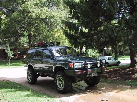

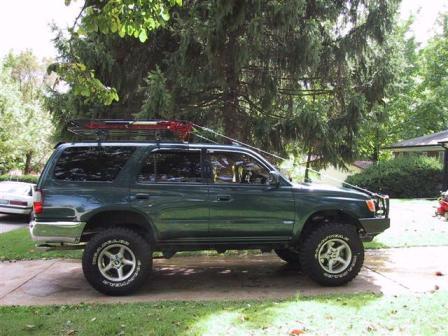

Wow, blast from the past. I'm responding a few months late, but I do have some pictures still if you want them. I attached them this time around as poboytech.net is down (and probably for good). If you need something more specific, let me know...
